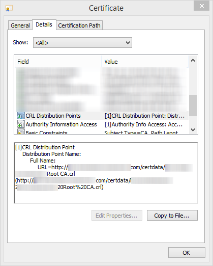

- Edit each component monitor script with the URL of the CRL to be monitored.
NOTE: The URL of the CRL can be found in the properties of a certificate issued by that CA. It is under the CRL Distribution Points section of the certificate:

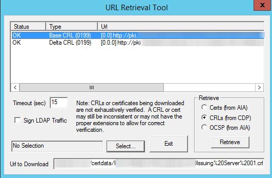

- Test the Monitor to ensure that the correct expiry in hours is returned.
NOTE: The date can be manually checked by using the CertUtil program on the Certificate Authority:
certutil -URL "http://pki.domainname.com/certdata/Issuing Server 01.crl"
