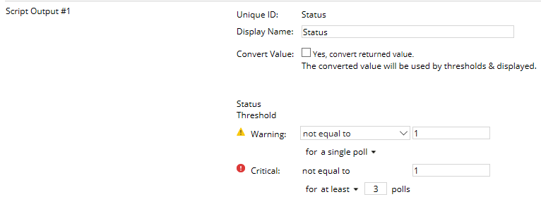

Back in the template settings, the script output is returned as a statistic called "Status". I evaluate my status thresholds as follows:
- Warning: not equal to 1 (OK) for a single poll
- Critical: not equal to 1 (OK) for at least 3 polls
