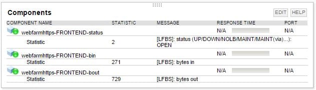

This template reports on the status and parameters of HAProxy by reading the Unix socket using Perl when provided with the proxy name, service name (FRONTEND for frontend, BACKEND for backend, any name for server/listener) and the parameter to be monitored.
Prerequisites: SSH and Perl installed on the target server with Net::HAProxy module.
Credentials: Root user on the target server.
Monitored Components
Status, Bytes In, Bytes Out
Each monitored component needs to have arguments in the following format:
perl ${SCRIPT} proxy_name service_name parameter
where parameter could be any of the field names listed under section "9.1. CSV format" of "HAProxy Configuration Manual".
You might want to name the monitors in the format, pxname-svname-parameter, to make it readable and easily understandable.
