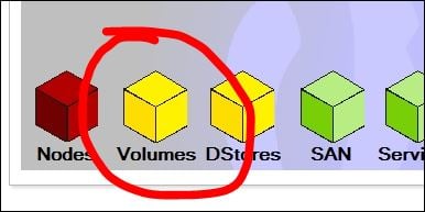

- Have it on your dashboard as a green/yellow/red blob (which is not possible out-of-the-box with SAM volumes)

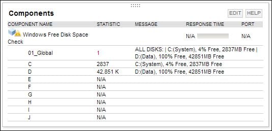

Component

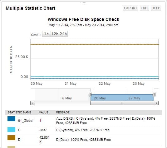

Multi stat chart

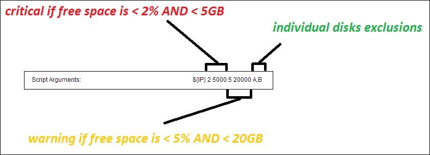

Script Arguments:

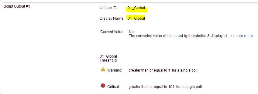

Global Statistic:

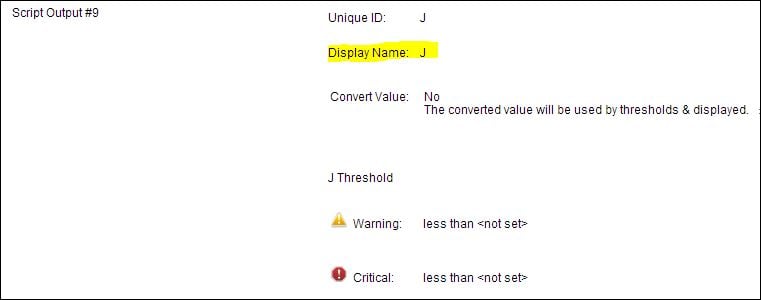

Individual Disk Statistic for global overrides (example for "J" drive)

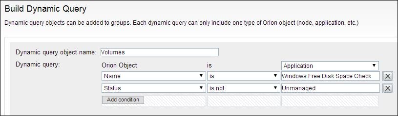

Dashboard:

- The biggest benefit for me (as my SAM is unlimited and first point is not really applicable) is that I can have it as a group item on my dashboard. Very handy. Screenshot above

>>> For the global threshold - this is achieved by incrementing "Statistic" counter in 100s for any critical breached disk and in 1s for any warning breached disk. (for example: Statistic value 102 means that we have 1 disk breached critical threshold and 2 disks have breached warning. Note, that when disk falls in critical level it will also be in breach of warning level as well. So, value 101 will indicate that 1 disk has fallen into critical level; likewise value 102 will indicate 1 disk critical and 1 disk warning)
>>> For the custom threshold - you just simply set values in SAM template for warning and for critical level for a particular disk

For example: disk F needs to trigger an alert when it drops below 150GB. In this case you would override script arguments with "${IP} 2 5000 5 20000 A,B,F" and you would set critical threshold to "less than 150000" as a SAM threshold value. You can also set SAM warning threshold as 200000 to be notified in advance
