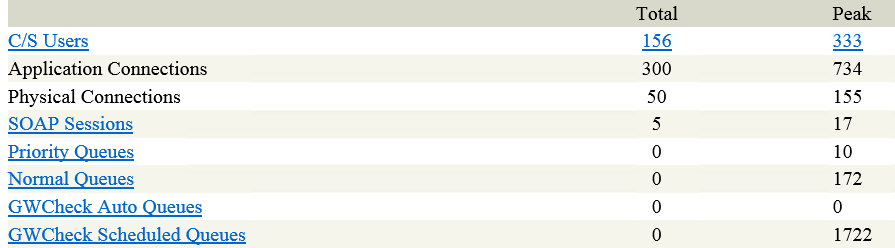

Out of the box, SolarWinds provides a handy template that captures a raft of GroupWise performance metrics by connecting to the Post Office Agent web page (default :7181) and using a nice PowerShell script to download the HTML and break it apart so that you can monitor the distinct metrics returned. That web page looks something like this...

Line number for the HTML output of http://$server:$port. Count starts at 0. This is the hardest part to figure out. I ran the script and then went and grabbed the output file from C:\Users\[username]\AppData\Local\Temp\16\APM-GW-[server_name]-7.txt and threw it into NotePad++. You just have to count out the line numbers to find where in the raw HTML your metric is stored and enter that value.

Count, from left, of <*> sections where the metric can be found. Count starts at 0. This is where the metric is found. The script breaks the line into sections on the <>. You can simple start counting on the line you specified and find where the metric lives. For example -- the metric is 0 for GWCheck Scheduled Queues. Starting at the left, start counting the <> until you get to the metric. In this case it is 9. Again, you can hard-code this into the PowerShell script and test via the ISE to validate your counting.
<TR><TD BGCOLOR="#F5F5EC"><A HREF="./queue/chk"><FONT SIZE=-1>GWCheck Scheduled Queues</FONT></TD><TD ALIGN="CENTER" BGCOLOR="#F5F5EC"><FONT SIZE=-1>0</FONT></TD>
<TD BGCOLOR="#F5F5EC"> </TD><TD BGCOLOR="#F5F5EC"><FONT SIZE=-1>1628</FONT></TD></TR>
