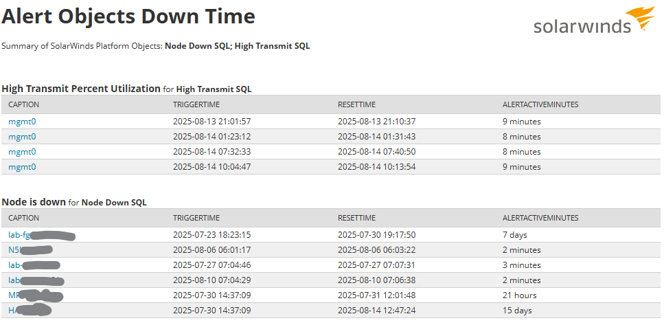

Want to know how long each alert last X days has been active? Then below report is for you.
It works on most Alerts, just change the to the name of the alert you want to report on, in the data source. You can also change the number of days back to want to report on.
Below example is for the two alerts "High Transmit Percent Utilization" and "Node is down".
The report use below SQL code:

I also have a SWQL code that is working in SWQL Studio but for some reason does not in the report:
