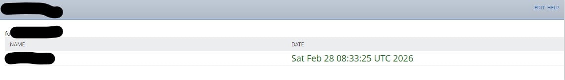

I built this with my temperature page that I made up a year or 2 ago in mind. One of our Networks guys wanted to poll the system expiration date on his Cisco ISE appliances via API and have it displayed in a similar fashion (Green Yellow Red)
The challenge was that this value is stored in a String format that makes date time calculations difficult. This script pulls that value, converts it to a datetime format, and then when used as the data source for a custom table with HTML tags enabled, will display the value accordingly (greater than 90 days to expiration is green, 89-45 days is yellow, 45 days and under is red)
You do need to find the corresponding value in the APIPoller_XXX tables referenced and pull the ID number to drop into the script. I have only been able to make this work with a single ID per widget but we are only monitoring 4-5 certificates at the moment.
