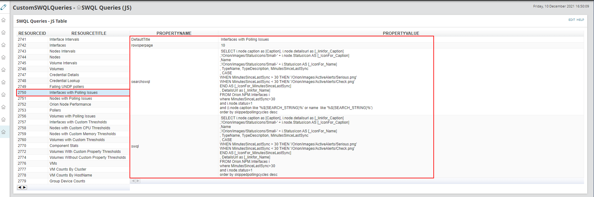

Once loaded into a custom HTML widget, you should see something similar to the screenshot below. This is the list of custom query resources in your environment.

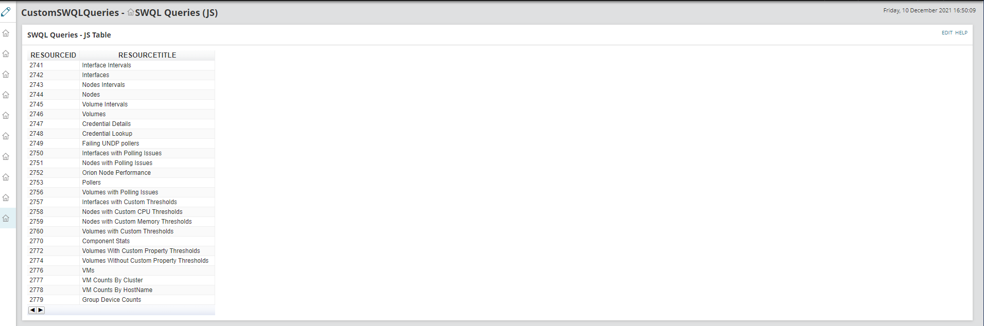

Clicking on any of the results listed in the table to the left will populate the contents of that resource, as seen below. If the resource has the search feature enabled, then queries for both the "SWQL" and "SearchSWQL" parts will be listed.

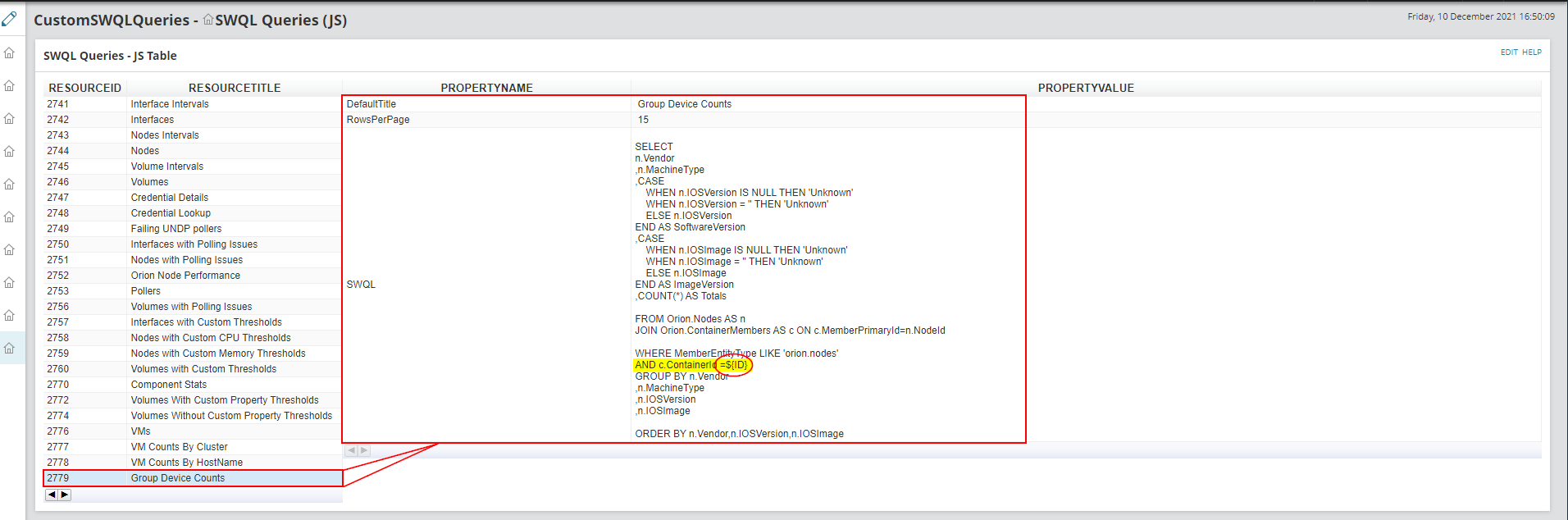

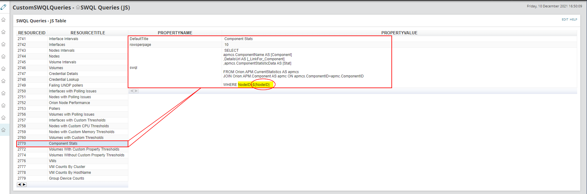

As always, if you get clever about how you title (and subtitle) the various custom query widgets, or add specific/coded comments within the queries themselves, you can create better filters. This can allow you to easily group similar purposed queries together, such as "Group", or "Node Detail", queries. As an example, looking at the 2 queries below, we could add to the filter within the table and only return results with ${ID}
or ${NodeID}
, returning only the results which would specifically be used on their respective view types. (Again, a good title/subtitle/commenting scheme can also make it very easy to categorize your queries too.)

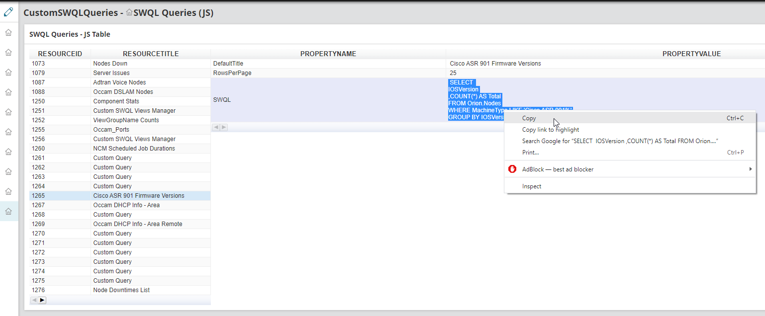

Once you find something you like, need, or want to use, you can simply copy it from here.

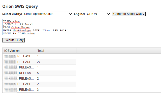

If you're in a pinch, and you have a couple helpful links handy, you can paste your query in and work on it directly within Orion itself. (/orion/Admin/swis.aspx)
