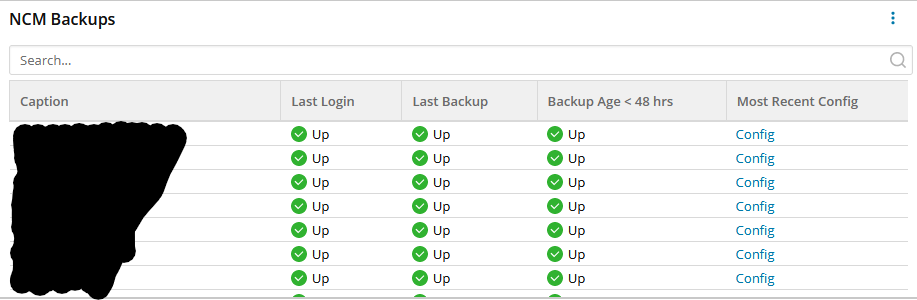

This query is an attempt to pull together as much information within NCM as far as its backup jobs go, NCM login status and the age of the last backup. It's not perfect and relies on a few not so ideal ways to join various bits of data but it's sufficient. Long story short, SolarWinds NCM could do a better job at auditing its own happenings.
Regardless, here's what the query shows and also a mockup of what it looks like if you use within a modern dashboard.
- Last Login status, "Login OK" = 1 (Status of UP, else 3 / Warning)
- Last Backup, "Successful" = 1 (Status of UP, else 3 / Warning)
- Pulls data from the NCM Job Audit logs based off IP Address match join
- Backup Age < 48 hrs = 1 (Status of UP, else 3 / Warning)
- Checks the attempted download time of the last backup
- Link to most recent config and its ConfigID
