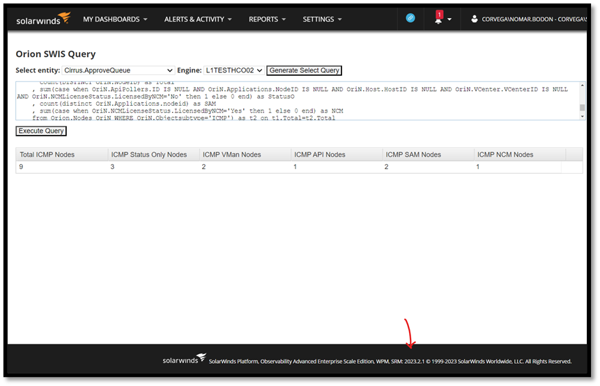

Determining your version of the SolarWinds Platform (fka Orion):
Please open your SolarWinds Web console to look at the footer of the website, which would present the version you are currently on for our application. This referenced image provides you a visual guide:
If you are on version 2022.3 or newer, then please go to this SolarWinds Thwack article to gain access to a report that you can import into your reports to run. Here is the corresponding video to show you how to import/export a report within your web console --> link
If you are running an older version of the SolarWinds Platform, then the below section would be the appropriate way to gather the necessary information to be properly licensed in the new product offering.

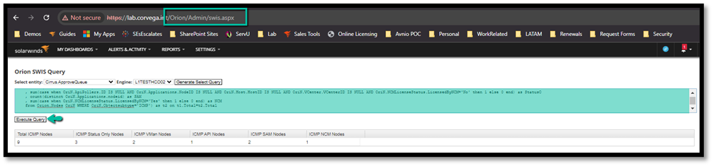

SWQL Query to run within your environment:
Please go to https://<your SolarWinds Server Hostname>/Orion/Admin/swis.aspx to then apply your modified query to execute the query. The results should be shared with your Account Representative.
Referenced in this image:
