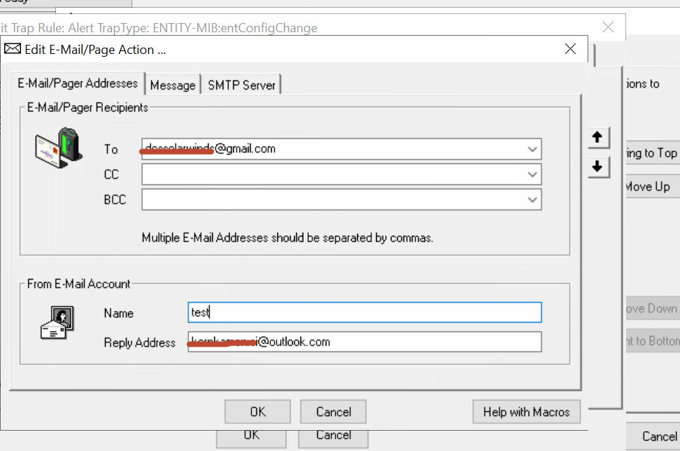

I'ved set trap rule to send an email on Trap viewer when configuration has changed or something went down.

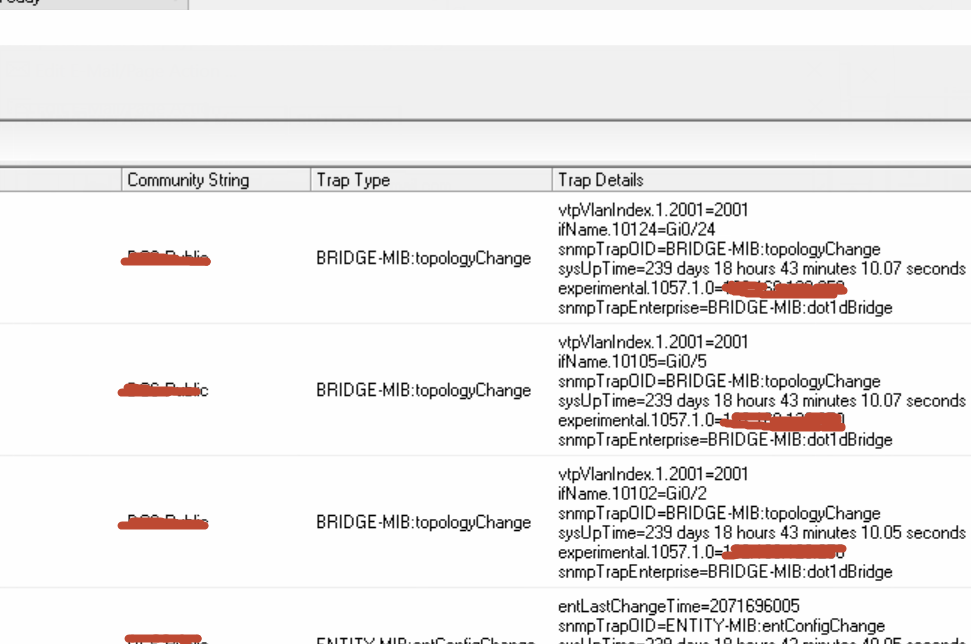

I did not recevive anything, but found log in current trap.

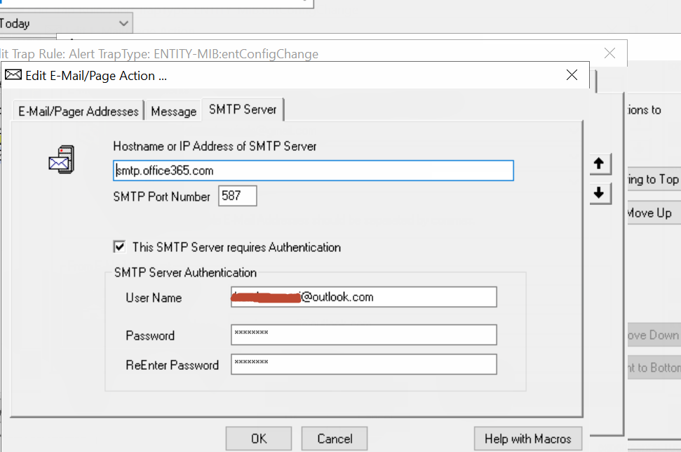

If the incoming messages do get written to the log file / get tagged / get a colour, then you need to troubleshoot the email configuration. It's been a while since I've used the legacy Trap Viewer tool but I vaguely recall a trapviewer log file somewhere under one of the C:\ProgramData\SolarWinds directories. I haven't configured Office 365 as a mail server before so a stab in the dark below.
I'm not sure if TrapViewer uses TLS 1.2 which is a requirement for the direct authentication method. You might need to look into Option 2 or 3 here (I think you're using option 1?).
docs.microsoft.com/.../how-to-set-up-a-multifunction-device-or-application-to-send-email-using-microsoft-365-or-office-365
