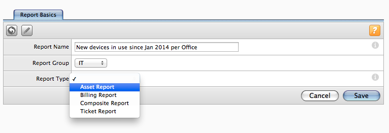

- Open the Reports page in WHD.
- Click on the "New" report button.
- Select "Asset Report".
- Don't forget to define a name and group (optional) for your new report.

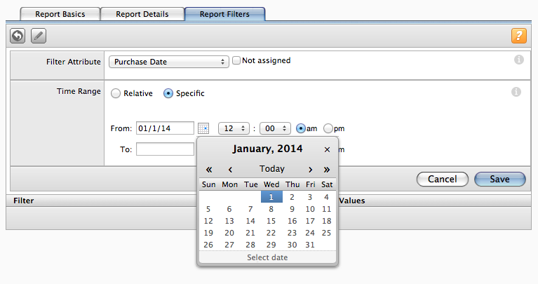

We are almost there. Now you want only assets purchased since January, so you
- move to Report Filters,
- click "New", and
- choose "Purchase Date".
- Next you define the purchase date from January 1st 2014.
- Now click "Save".

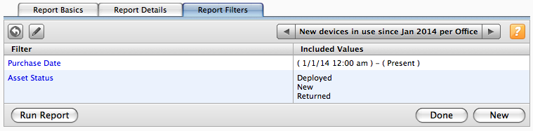

The last filter we need is "by Status", since your manager asked for only devices in use.
- Click on "New" again in the Report Filters tab.
- Choose "Asset Status", and check the values which represent devices in use in your environment (most likely these are "Deployed", "Used", etc.).
- Click "Save".

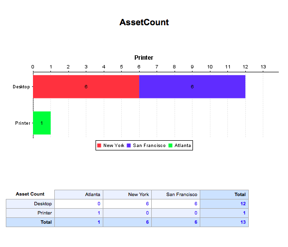

Now we are ready, to run the report, and there is it. Answer for your boss visualized in a nice bar chart.

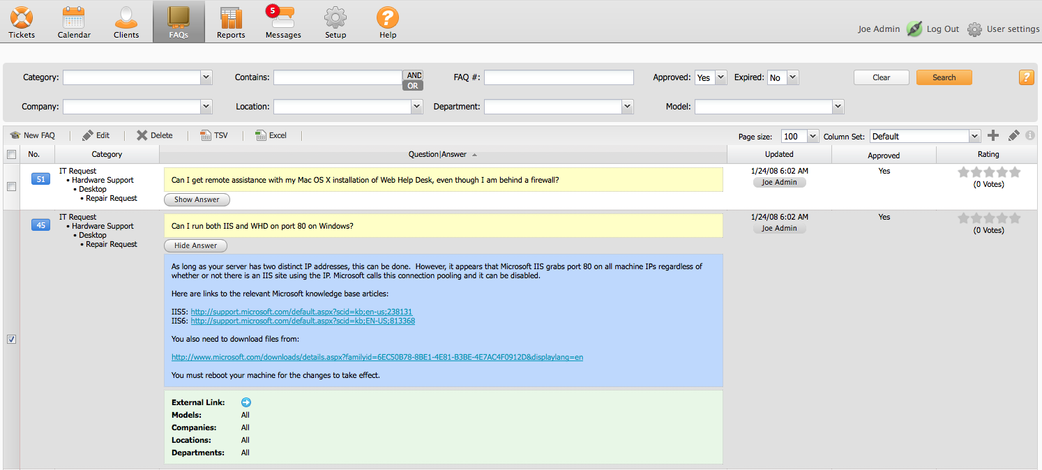

Sometimes you might find Question/Answer column in FAQ list too narrow.
We are working on improving the UI, so that columns are both easily resizable and moveable. Thus making UI far more flexible.

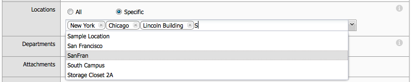

If you have a large system with hundreds of Locations or Techs, the new UI we are working on can support large deployments and has UI elements to make the work with large volumes of objects much easier. Instead of checkboxes, you can add objects to the list by browsing a list or typing the names with auto-complete. For example when defining Locations for FAQ.

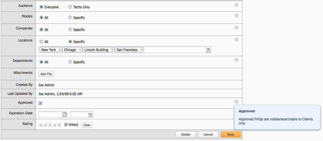

Another example of improvement is a more detailed help system with new tooltips and details on individual settings. Our goal is to provide on the spot help when and where it's needed.
