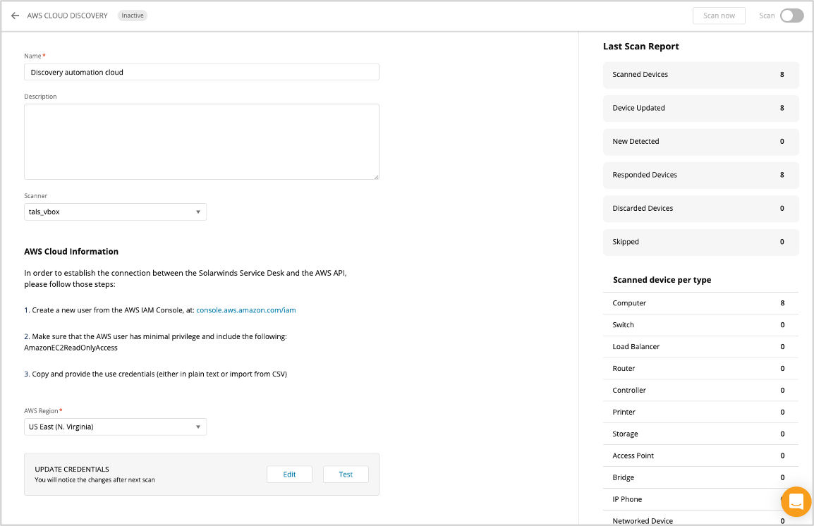

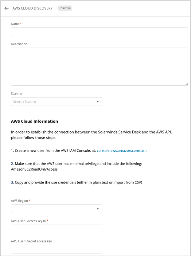

1. Navigate to the Setup Menu → Discovery → Connections. Click on ‘+’ and select ‘AWS Cloud Discovery’.
2. Select the Discovery Scanner that will establish a connection with AWS and add details about the AWS region and user (Access Key ID and Secret Access Key).
3. Test the AWS connection, run the Scanner, and check the Last Scan Report.

- You must create a new user in the AWS IAM Console (console.aws.amazon.com/iam) in order to connect to AWS
- We recommend that the user has read permissions only (AmazonEC2ReadOnlyAccess)
- You must setup the Access Key ID
