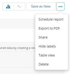

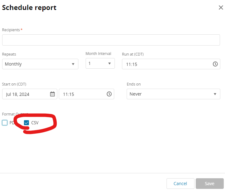

Right, I figured that. I did a little research and some testing. The only thing I see that could possibly work is if you go to Analytics>Reports and then select the type of report you would want for Incidents. As far as I can see, there is not a way to filter by "View" BUT you could consider selecting the categories that apply, or however you determined the view, filter on the same things. Then, you would "Save as New". Then, under the 3 dot menu, select "Schedule report". Once you do that, there is an option to export CSV, and schedule it to send via email to whomever you need to.

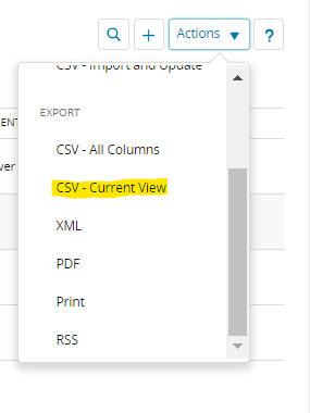

Since you have them saved as a view, go to that particular view. Then, on the top right, there is an Action drop down. You can choose the option under export that says "CSV-Current View" (see picture. I'm not sure that there is an option to have SolarWinds email that. I will look around a bit more to see though.
It's the email part I'm having trouble finding too.
