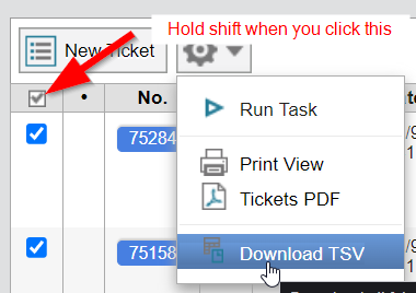

I did it for something internally recently and found that I got what I needed by doing a search with no criteria. Then I held shift while clicking the "select all" square at the top left, then exported them all using the cogwheel button and selecting "Download TSV". It may take a wqhile depending on how many tickets you have but it worked for my needs. Just make sure to hold shift when you click the button otherwise it will only export the tickets on the first page.

Totally forgot you could export them as PDFs as well. That looks a lot nicer but can be harder to search.
