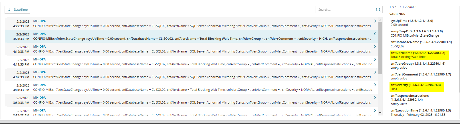

In HCO you can check the "Logs" dashboard and filter for "log type" of "traps". Here is an example of the relevant trap for an alert trigger. A reset event will look almost identical, except the cnfAlertName will be "NORMAL". In this example I've highlighted the 2 varbinds that will be used to create the log filters.

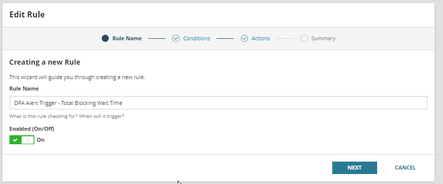

So the next thing to do is create 2 rules to handle both the trigger and reset logs. You can follow the steps here to create the rules . I like to include the keywords "trigger" or "reset" in the rule name, as it's useful later. In my example I went with "DPA Alert Trigger - Total Blocking Wait Time"

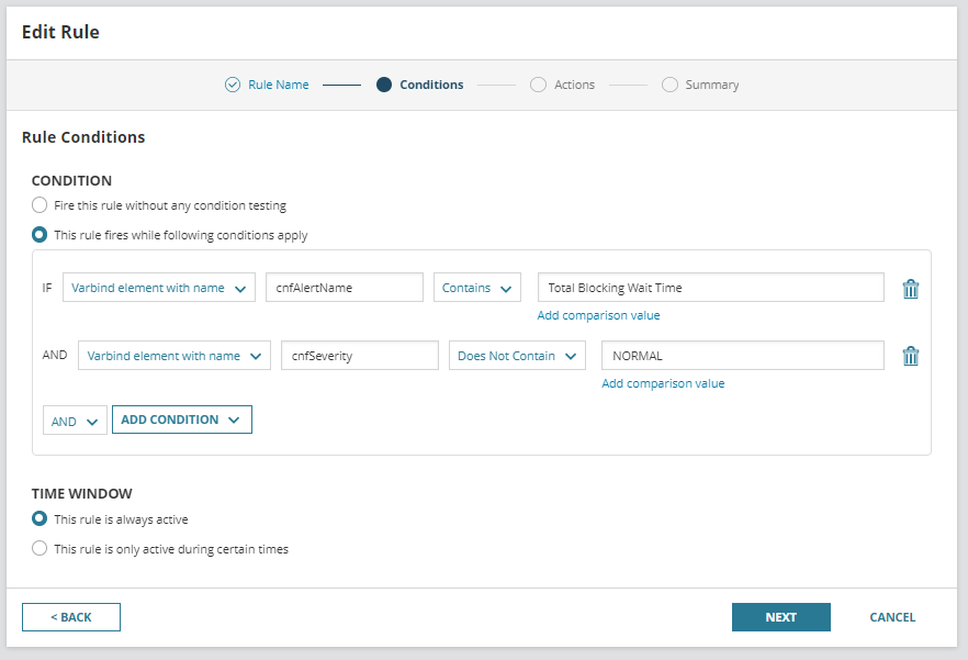

But the main settings to include are under the conditions to add in the necessary logic for the varbinds above.

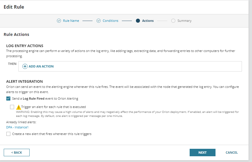

And then under actions ensure the option for alert integration includes the option to "Send a Log Rule Fired event to Orion Alerting" is set.

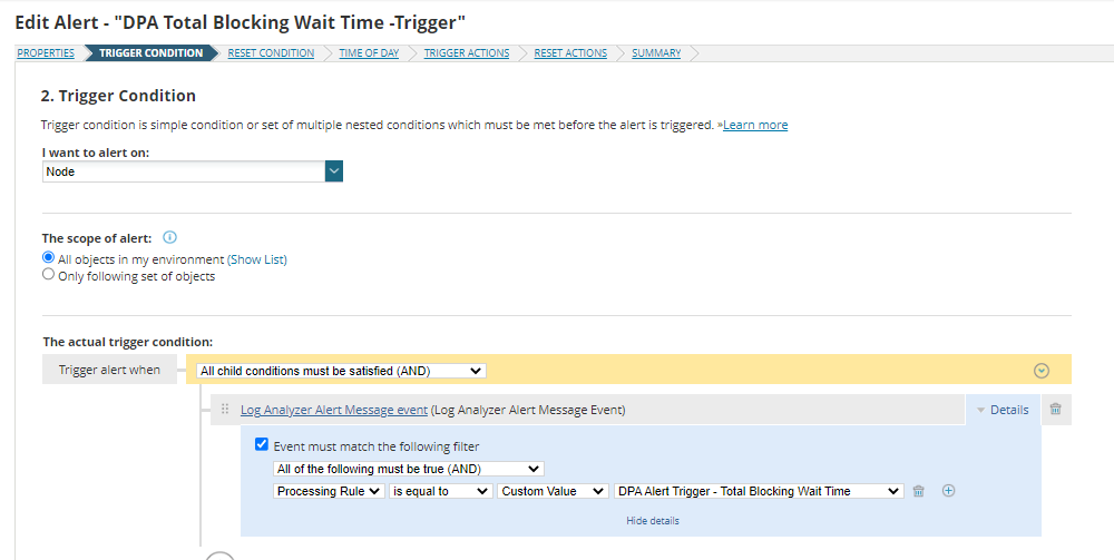

In our use case we will use the alert created when we created the first alert as our base. More info for alert configuration is available here Under "settings"-"manage alerts" I'm going to select and edit the alert that was created when we created our log rule. In this case we can see the logic for the "trigger condition" is a "Log Analyzer Alert Message Event" where the "processing rule " equals the name of our first trigger rule (don't worry, this will be populated).

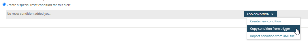

But on the "reset condition" is where we make a big change
In this case I'm going to select "Create a special reset condition for this alert" and copy the condition from the trigger

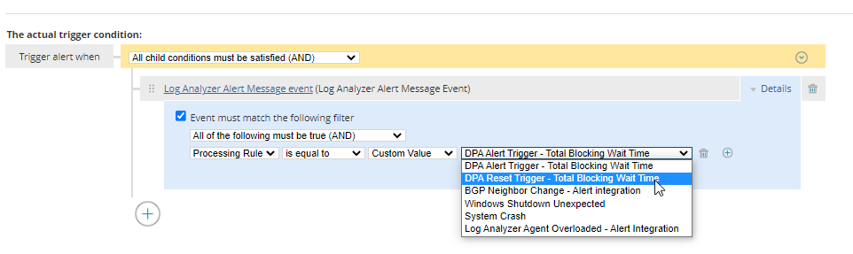

Next I'm going to select the "reset" rule from the drop down list
