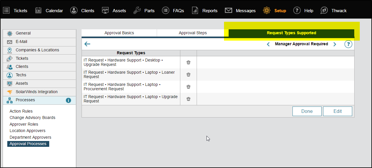

if you open up an approval process you can then go to the "Request Types supported" tab and remove the ones that you no longer wish to be associated:
