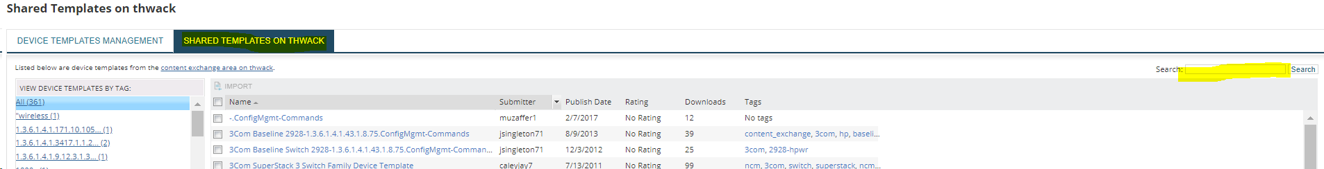

Other options Search on Thwack if there is other template available uploaded by community ?
Settings > All Settings > Manage Device Templates
