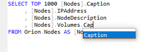

Additionally, when working with entity aliases, SWQL Studio can help you understand the navigation properties and properties as you type your queries.
Aliases Inform Navigation Properties

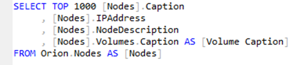

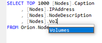

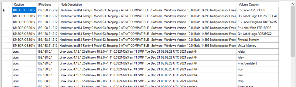

The primary reason to reformat with entity aliases is to gain easier access to navigation properties and their respective child properties. If we wanted to get information about the volumes assigned to these nodes, we can just start typing and the Intellisense will kick in to assist.
Volumes is the name of the navigation property bound to Orion.Nodes.
Caption is a property on the Orion.Volumes connected navigation property.
We’ve aliased the Volume’s caption to a better name, and our results are easily comprehendible.

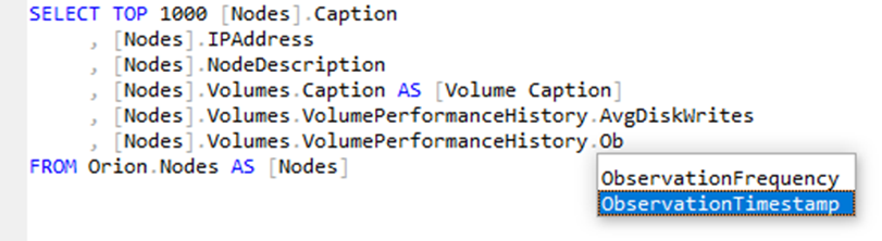

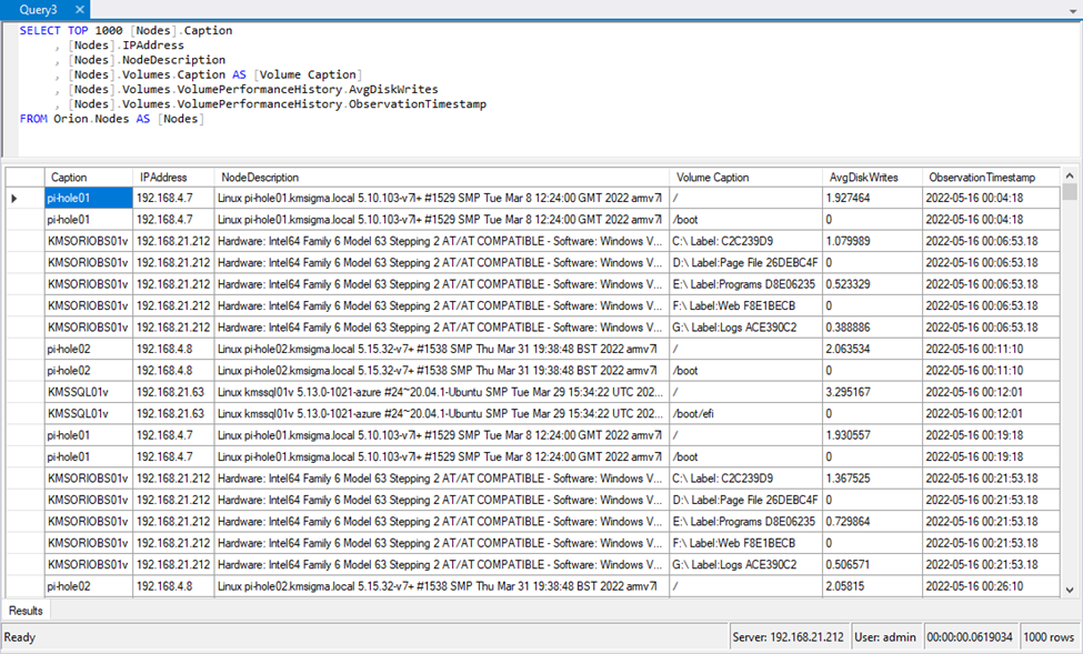

With aliases, we can continue to go further. For your own experimentation, connect to volume performance history and pull in average disk writes and observation timestamp.
You now have more than the 1000 rows that you are limited to by the SELECT clause.

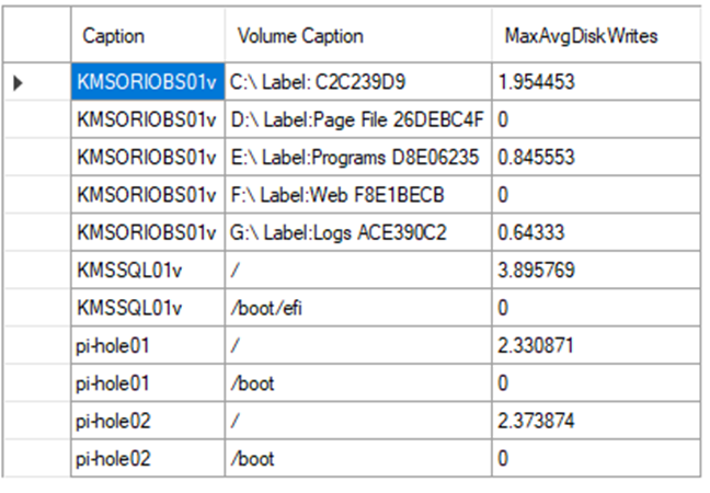

If you wanted the maximum of the average disk writes broken down by the disk, but including the node, and only for the last 24 hours, you can start building that using the examples from earlier in this chapter.
SELECT TOP 1000 [Nodes].Caption
-- , [Nodes].IPAddress -- Not needed in results
-- , [Nodes].NodeDescription -- Not needed in results
, [Nodes].Volumes.Caption AS [Volume Caption]
, MAX([Nodes].Volumes.VolumePerformanceHistory.AvgDiskWrites) AS [MaxAvgDiskWrites]
-- , [Nodes].Volumes.VolumePerformanceHistory.ObservationTimestamp -- Not needed in results
FROM Orion.Nodes AS [Nodes]
WHERE [Nodes].Volumes.VolumePerformanceHistory.ObservationTimestamp >= GETDATE() - 1
GROUP BY [Nodes].Volumes.Caption
, [Nodes].Caption
You can see that although SWQL Studio is a powerful tool, knowing the basics of query construction and some best practices can help you take this tool even further.

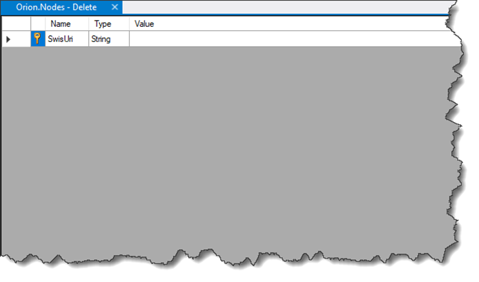

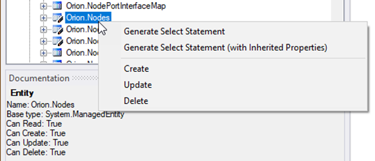

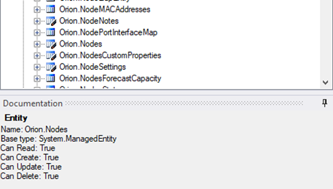

Each entity has included documentation which will provide information on the actions available on the entity in question. If we continue to work with the Orion.Nodes entity, we can see that this entity supports Read, Create, Update, and Delete. This is further indicated by the icon for the entity which includes a ‘pencil’ overlay indicating that at least some edits are possible.
Additionally, this entity shows actions beyond standard SELECT query on the right-click menu.

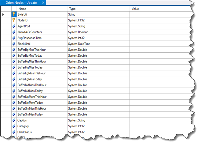

To delete an entry, you’ll need the SwisUri value.
For updates you’ll need the SwisUri and the field you wish to alter.

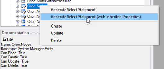

The URI is not part of the standard output for a query but can be exposed by either adding the “Uri” property manually to an existing query, or by right-clicking and selecting “Generate Select Statement (with Inherited Properties).”
This secondary query builder option will generate a new query will all the properties and inherited properties. In typical uses, this is unnecessary since most inherited properties are aliases of other properties (for naming consistency across the platform), except for exposure of the URI.

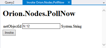

Working from a simple example, we can use the API to request that a node be polled.
The parameter list here includes only one parameter. This parameter is expected to be a string and is called netObjectId. This is one of two commonly seen parameters for unique identification of an element (with the other being the URI). Each verb will normally require either the netObjectId or the URI to identify the target of the action of the verb. URI is more commonly utilized for newer verbs and netObjectId is more common for legacy verbs. Refer to the parameter list of the verb in question as to which should be used.

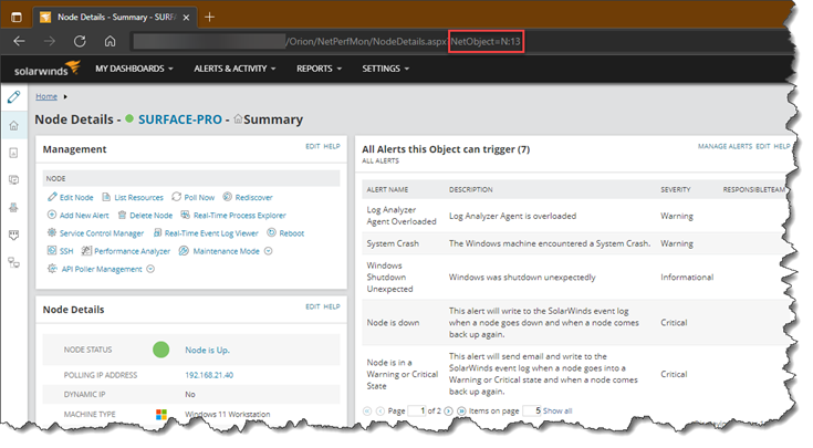

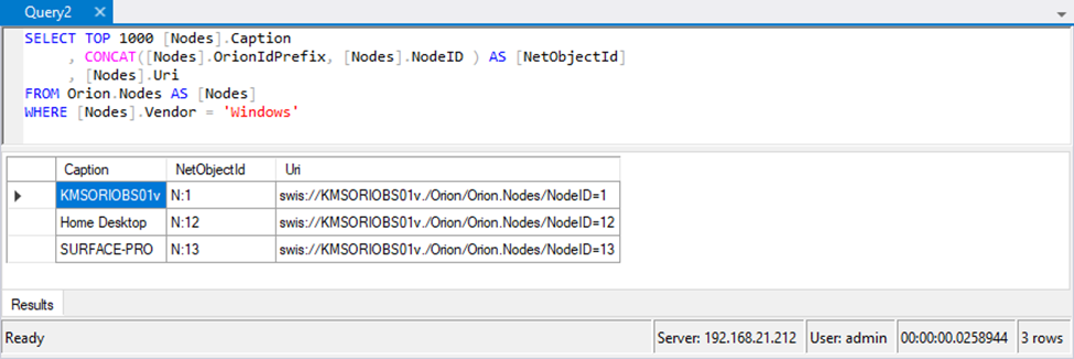

If we wanted to use this verb to immediately poll all Windows nodes in our environment, we would need the netObjectId for these nodes. Although not explicitly documented within the API, the netObjectId will already be familiar to users of the system, as it is what is typically added as a URL parameter to an element details web page. Network object IDs all follow the format of an alphabetic prefix, a colon, and a number.
This can be retrieved using a simple query (where we will also be including the Uri for completeness).
In the previous query, we are using a string function (CONCAT), which concatenates the properties listed. The full list of functions and their uses can be referenced on the Orion SDK Wiki page for SWQL Functions.
If we wanted to immediately send a poll request for the “Home Desktop,” we can invoke the PollNow verb and pass ‘N:12’ as the value for the parameter.
When we click the “Invoke” button this information is sent to the API and the result is returned and displayed in the lower pane.
You can see that the result here is “true” meaning the request was sent successfully. Other verbs may return other information – it will always be displayed in an XML format when using SWQL Studio.
