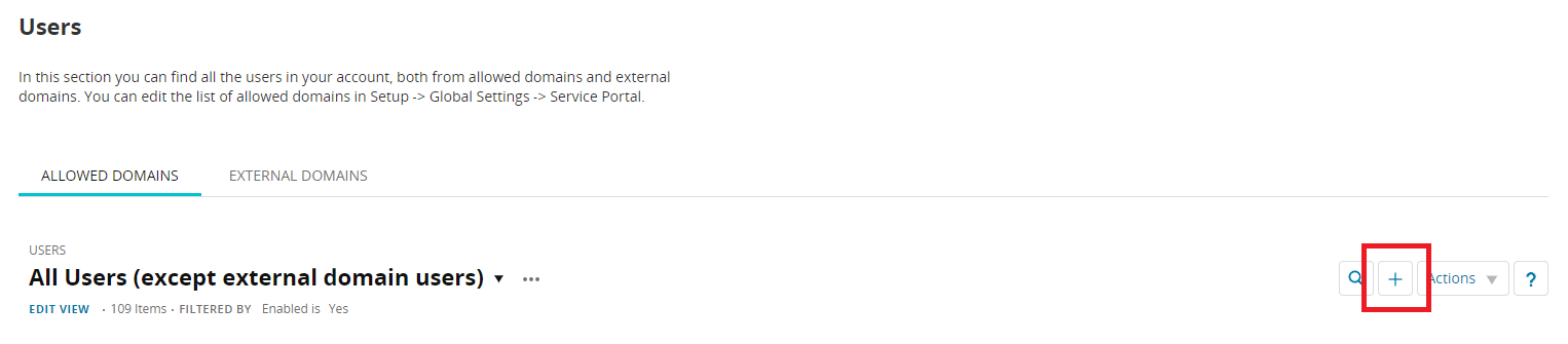

Absolutely. You can still create local accounts within SolarWinds Service Desk. Take a look:

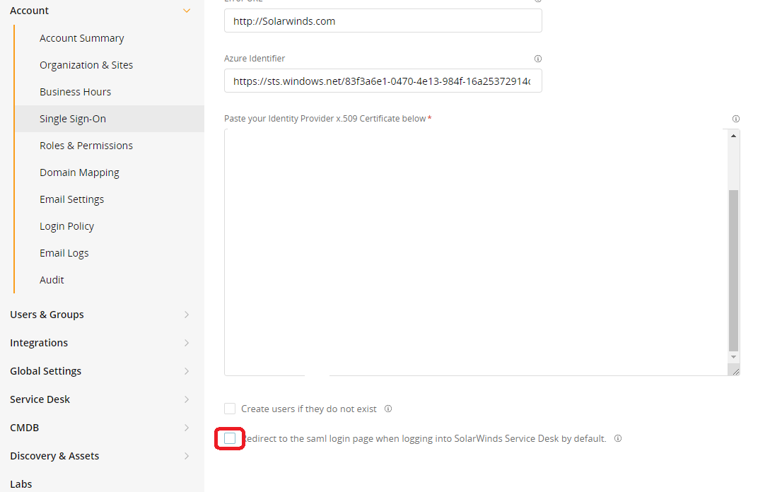

What you may be having trouble with is that you're being redirected to the Azure SSO when you're trying to login, so you're not sure how to authenticate if you are not using an Azure account. That setting is in the SSO Setup:
What I think you want is a native login URL. Modify this then try logging in:(https://<ACCOUNTNAME>.samanage.com/login?native=true)
