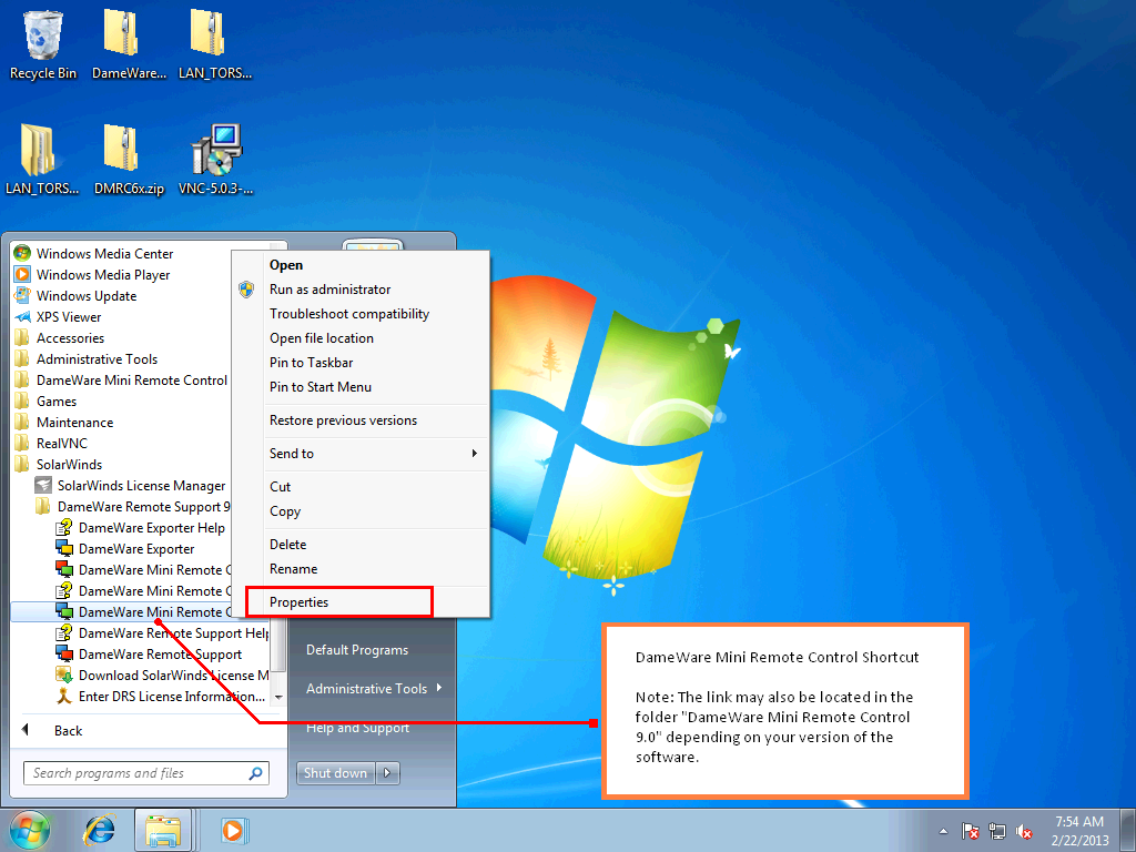

a. Right-click the DMRC shortcut icon and select "Properties"

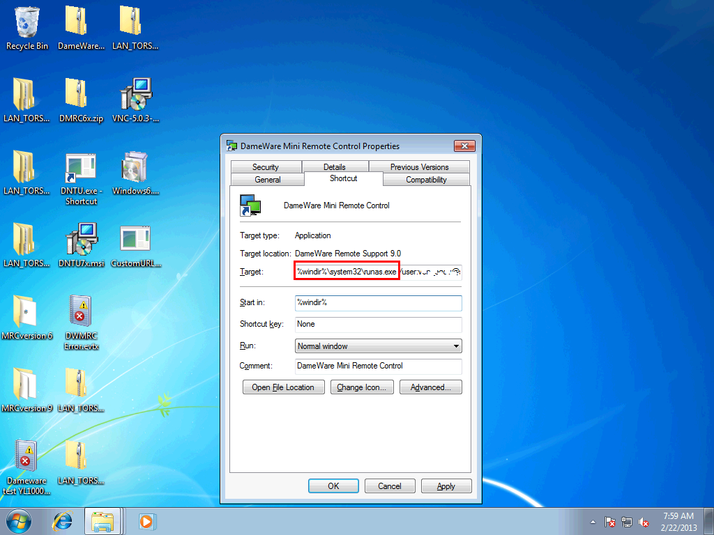

b. Open the "Shortcut" tab

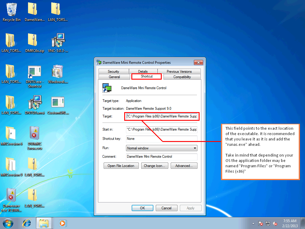

c. Add "runas.exe" in the "Target" field using the following syntax:
%windir%\system32\runas.exe /user:username@domain "C:\Program Files\Solarwinds\DameWare Mini Remote Control 9.0\DWRCC.exe"

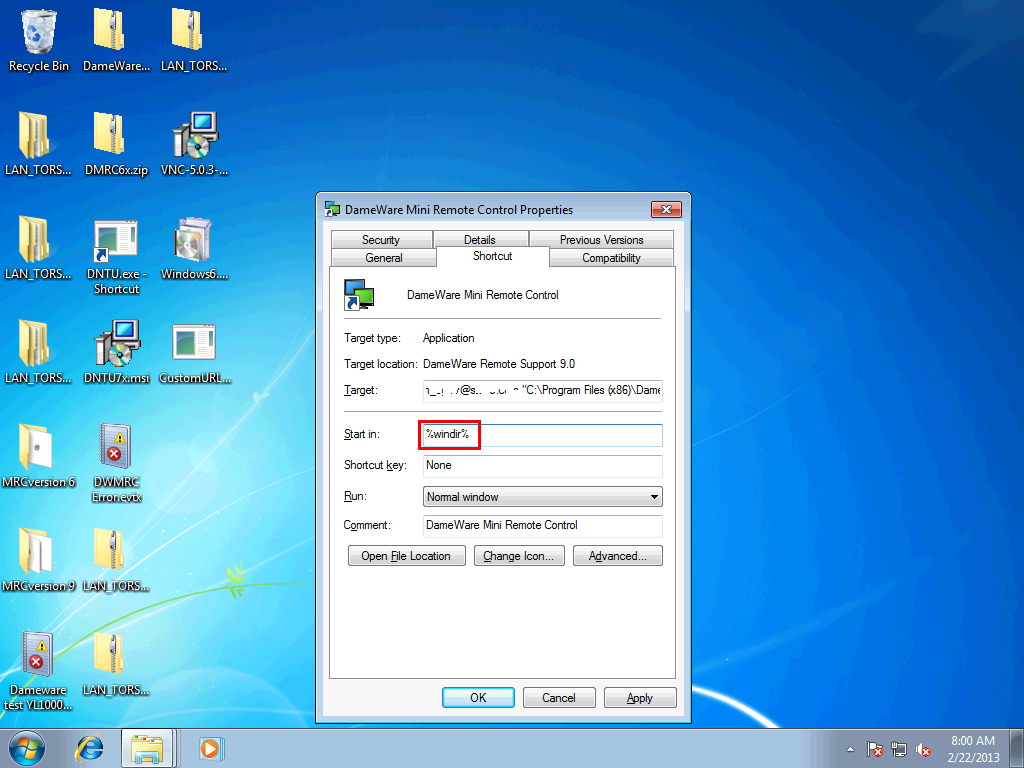

d. Modify the "Start in" field to: %windir%
e. Click OK
