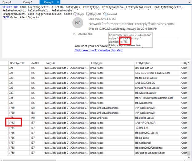

Once it's done, I'll kick off that alert, receive the email, and see what that link looks like.
Let's SWQL One More Time
Now that I know what the link looks like, I have to go back to SWQL studio and see if I can find that link or at least a portion of it embedded SOMEWHERE. After just a bit of searching, I found it in the AlertObjects table, where there's an AlertDefID field that matches up with the tail-end of the standard alert URL "/Orion/Netperfmon/AckAlert.aspx?AlertDefID=".
By concatenating the AlertDefID onto the end of that URL, I'm in busine...

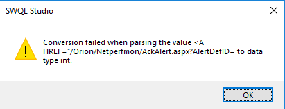

Hang on, it threw an error.
The issue here is that the URL is a word-based object (a "string" or "varchar" in in more technical parlance) but the AlertDefID is a numeric value. So, we need to convert them to match. Since you can't make words into numbers, we'll have to convert the AlertDefID number so that it's treated as a string:
tostring(AlertObjects.AlertObjectID)
The final field description would look like this:
'<A HREF="/Orion/Netperfmon/AckAlert.aspx?AlertDefID='+tostring(AlertObjects.AlertObjectID)+'" target="_blank">ClickToAck</a>' AS AcknowledgeIt

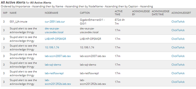

I'll add that to my SWQL statement, update it in the report definition, add the "AcknowledgeIt field to the report, and I have something that looks like this:
