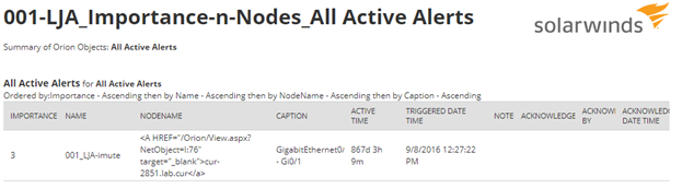

Adding the new column to the table will yield a report that looks like this:

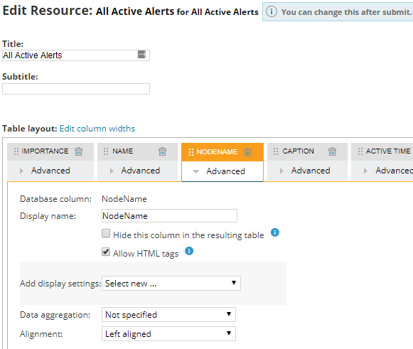

Obviously, we have a problem with display. Click the “Advanced” arrow for the new NodeName column and check the “Allow HTML Tags” checkbox.
This will cause Orion to interpret the HTML tags correctly and give you a report that looks more like this:
