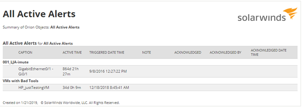

Going to the Reports, All Reports menu, I found my starting report and opened it to see what it looked like.
Taking this as my starting point, I knew there were a few things I wanted to do:
- Add my custom property for node importance
- Sort the report by the importance value
- Get rid of the grouping

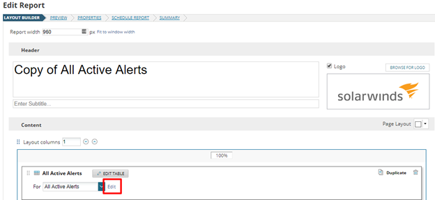

Of course, I don’t want to directly edit this report because I may want to fall back to the original at some point, so instead of clicking “Edit Report,” I go back to the report list and click the “Manage Reports” link in the upper-right corner. Then I find my report again, select it, and click “Duplicate and Edit.”
Now we’re ready to get to work. Of course, you should change the title of the report first thing, along with other essentials like the logo, footer, etc. But the meat-and-potatoes of the work is the tiny little “edit” button that rests next to the “For” drop-down.

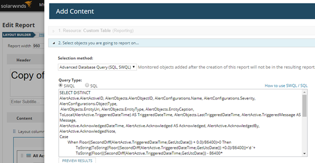

Clicking this will bring up the “Add Content” window, and you’ll be automatically dropped into the query editor. There are other options—static device selection and a dynamic query builder that strongly resembles the system used to create alerts. But we’re going to focus on SWQL because that’s one of the most useful (and often least-appreciated) skills a monitoring specialist can develop.
From within that window, you can include additional tables, add fields, and more. There’s only one problem: there’s no explorer, let alone a “test” option, so you have no way of knowing if any of your edits are going to work.

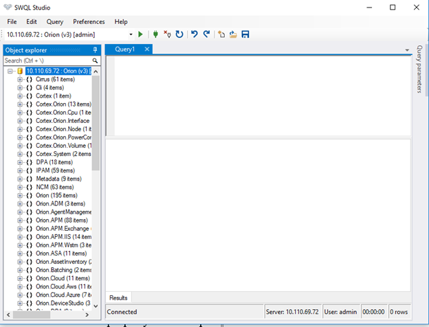

Getting connected in SWQL Studio is just a matter of inputting the name or IP of your primary Orion polling engine along with the username and password you normally use to log in through the web portal.

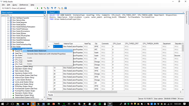

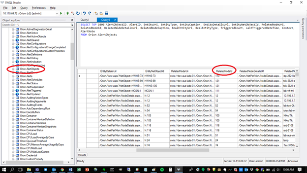

Now the first thing I want to do is make sure I know where those darn custom properties are. If you’ve used SolarWinds tools for a few years, then you know they’ve moved from the main Nodes table into their own table.
I didn’t use any magic tricks here. I just kept clicking and searching until I found something that said “custom properties” on it. To be certain it had the information I wanted (i.e., the “Importance” custom property”), I right-clicked the table and clicked “Generate Select Query,” then the “Run” button to see the data.
Scrolling through the columns, I found the “Importance” column and verified the data, so I knew I had found what I needed.

First things first, I needed to pull the query out of the existing All Alerts report. This didn’t prove difficult at all, as I just duplicated the existing report (because I’ve worked in IT for more than 15 minutes, so I know to make backup copies of everything), click the “Edit” link next to the data source drop-down, et voila! There’s my query.
I can cut and paste that into the SWQL Studio just to see how it runs.
Now, the next step really leans on your existing SQL knowledge. You should see that the Custom Properties table uses NodeID as its key field. The question is whether that data exists in any of the tables that the original All Alerts report uses. To figure that out, I found each of the tables in the All Alerts query and did that same “Generate Select Query” action to see what fields were there.
Wouldn’t you know it, the Orion.AlertObjects table includes a “Related NodeID” field, which works perfectly for us. Now I can add the table source to the bottom of the All Alerts query with this line:

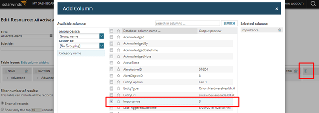

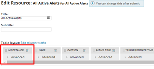

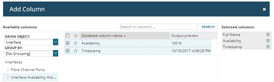

But that’s only half (OK, more like three-quarters) of the battle. Just because I’m pulling that field into the data source doesn’t mean it’s going to show. Now I have to use the “Edit Table” button to add the new field.
And move it to the first column position.

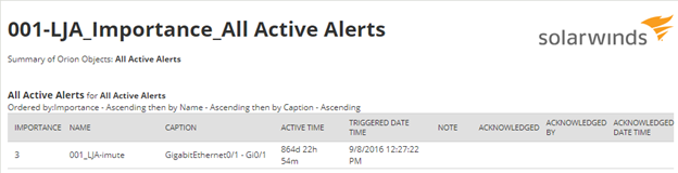

Now I’m able to customize the report display by removing the grouping (that’s just a personal preference of mine) and sort the results first by importance, then by alert name, and finally by node name.
When I run it, I have the report I wanted (at least so far).
