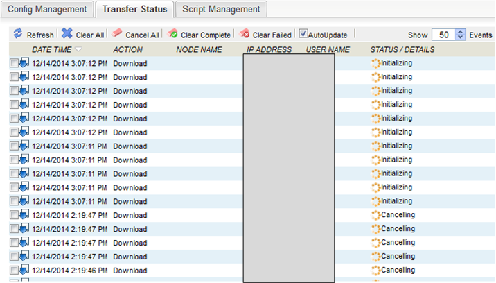

So, not having a lot of time to try and figure this one out, and knowing that the list I gave them probably would end up a bit confusing and incomplete, I decided instead to give them the tools so that they could look up the MAC addresses themselves. How you ask? I happened to know that NCM downloaded ARP tables of all my routers, and since that's basically how I got it off the router in the first place, it was just a matter of somehow giving them access to this information easily. So, I created a resource which does just that. You an put the resource on any page you want in Orion. Once there, plug in the start of an IP address and it will give you the MAC address(es) associated with those IP's that begin with that IP. So, in the example shown below, the .13 address is our router, and the .1 IP is the cable modem.
Also for the fun of it, I added in MAC lookup to it also, type in part of a MAC and it will search for that.
It's very easy to adjust it to fit your own needs. I have it searching for an IP that starts with what you put in the search box, but adding a "%" at the beginning of the search pattern, you could easy change it from "starts with" to "contains". With the MAC address part of the search I have it set up to do "contains", which could easily be change to a "starts with" or "ends with" type pattern too.
