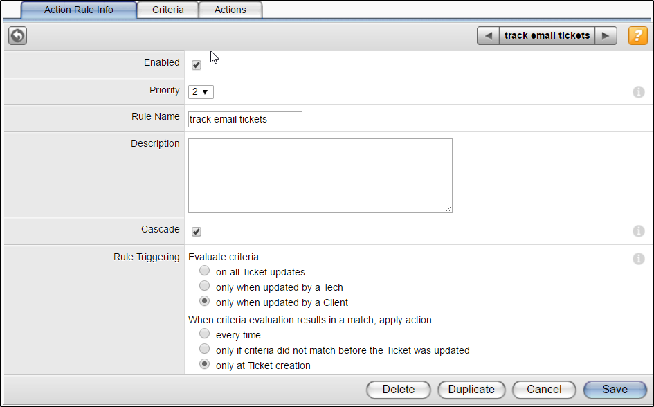

In a nutshell, you could create 2 different Action Rules that check the tickets when they are created and automatically does one of the following things:
In that type of setup my first Action Rule would look like this:

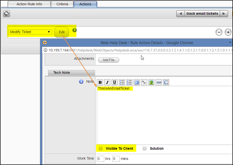

Alternatively, on this Actions tab I could choose to do something other than adding a Note, like choosing a particular value in a Custom Field.

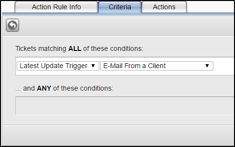

Since the steps above only cover the email tickets, I would repeat the steps above to add a 2nd Action Rule.
The main differences there is that the second tab would have a rule for Latest Update Trigger = Client Interface
and the third tab's Action would be putting in a slightly different (but still easily identifiable) bit of Text into a Note or setting a slightly different option on the Custom field.
This is what it would look like:
As you might surmise, having 'extra' notes or custom fields in my tickets might be somewhat annoying if you had to have it long term, but it would be pretty to leave something like this in place for a short amount of time. It would make it easy to search on all tickets in that time range that have a Note with "ThisIsAnEmailTicket" or "ThisIsAPortalTicket" to get a count.
