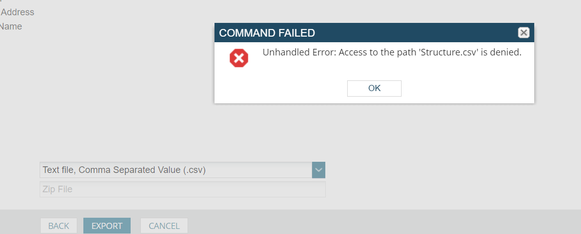

What version are you using? If I remember correct there was a bug about that a couple of years ago.
2023.1
Ok, then it's not that bug.
Just tested myself on the same version and that worked. Do you have permission to all networks and addresses on that network?
yeah i have admin permission but still i'm facing this issue.
Ok, my last idéa. There is a tool on the orion-server called "PermissionChecker". Checks that all the permissions on the actual orion server is correct. You can try that, otherwise I would suggest a support call
https://support.solarwinds.com/SuccessCenter/s/article/Check-permissions-using-the-Orion-Permission-Checker?language=en_US
I encountered this issue before. Did you try to open a ticket under support?
I believe the ticket I had was 00605881. When you do an export, folder: it downloads the file on C:\ProgramData\SolarWinds\IPAM\Export\... folder. If the file is there created, and the user is getting the error, check the permissions to the folder: C:\Users\userName\Downloads, username should be username which is logged in to the Orion server and creating the export file.
IPAM is copying the exported file from C:\ProgramData\SolarWinds\IPAM\Export\... folder to theC:\Users\userName\Downloads folder.
When the file is created in folder C:\ProgramData\SolarWinds\IPAM\Export\... folder and not created in downloads folder, there is some problem with permissions for this user.
That's what I remember from the ticket way back 2020.
support.solarwinds.com/.../Unable-to-Export-Subnets-in-IPAM-after-upgrading-2023-2
