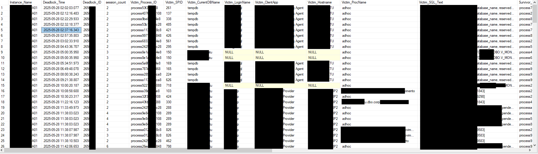

Here is a sample of the output:
Instance_Name: The name of the SQL Server instance where the deadlock occurred.
Deadlock_Time: The timestamp of when the deadlock was captured.
Deadlock_ID: A unique identifier for the deadlock event.
session_count: Number of sessions involved in the deadlock.
Victim_Process_ID: The process ID (in the XML) that was chosen as the deadlock victim.
Victim_SPID: The SPID (session ID) of the victim process.
Victim_CurrentDBName: The current database name in use by the victim process.
Victim_LoginName: The login name of the victim process.
Victim_ClientApp: The client application name of the victim process.
Victim_Hostname: The hostname (machine) from which the victim process originated.
Victim_ProcName: The stored procedure or batch name involved for the victim process.
Victim_SQL_Text (only if @ExportSQLText=1
): The SQL text executed by the victim process.
Survivor_Process_ID: The process ID of the survivor process.
Survivor_SPID: The SPID (session ID) of the survivor process.
Survivor_CurrentDBName: The current database name in use by the survivor process.
Survivor_LoginName: The login name of the survivor process.
Survivor_ClientApp: The client application name of the survivor process.
Survivor_Hostname: The hostname (machine) of the survivor process.
Survivor_ProcName: The stored procedure or batch name involved for the survivor process.
Survivor_SQL_Text (only if @ExportSQLText=1
): The SQL text executed by the survivor process.
Deadlock_XML_XDL (only if @ExportDeadlockXML=1
): The full deadlock XML for the event.
In this script, for each deadlock record:
It identifies the victim process using the Victim_Process_ID
and extracts detailed information about it (SPID, database, login, application, etc.).
Then, it uses a CROSS APPLY on the process list inside the deadlock XML to select all processes whose ID is different from the Victim_Process_ID
This means:
For each deadlock, there will be one row per survivor process in the final result.
If a deadlock has 1 victim and 2 survivors, the script will generate 2 rows in the output:
This way, the final result clearly details every victim-survivor relationship, allowing you to see which processes survived and their context (SQL text, application, hostname, etc.). It’s a useful way to understand all the processes involved in the deadlock—not just the victim, but also who was on the other side of the deadlock.
