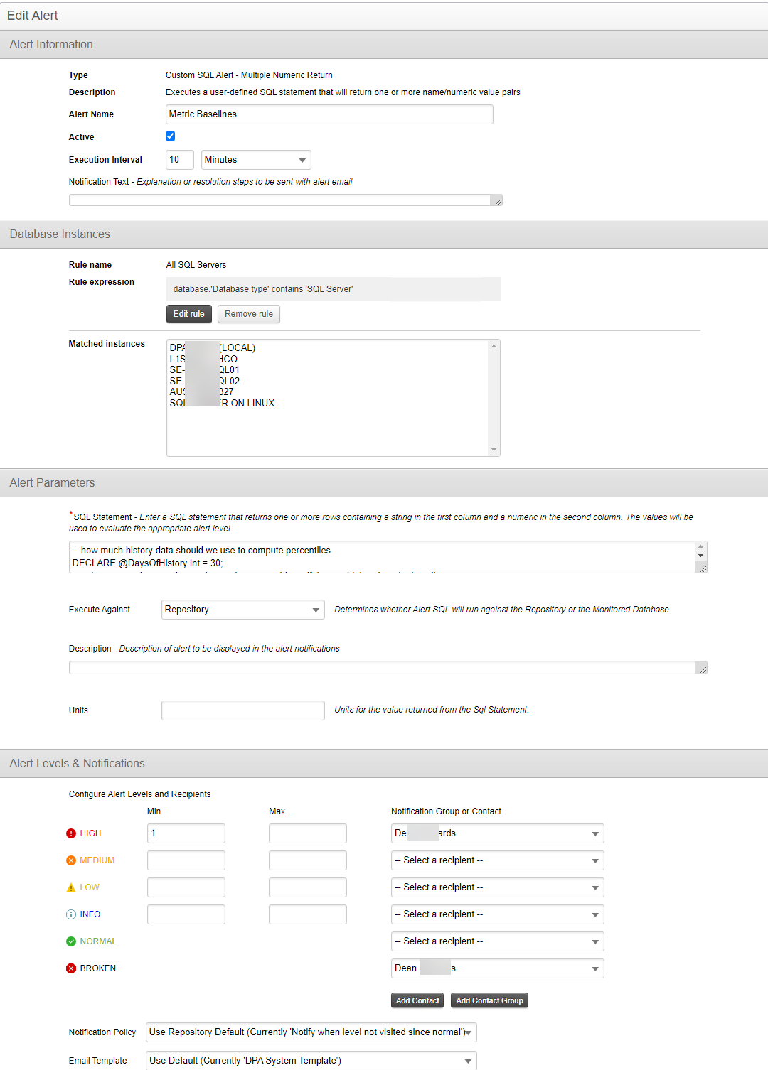

Configuring the DPA Alert
To add this alert to DPA, create a custom alert of type Custom SQL Alert - Multiple Numeric Return and make it look similar to this:
