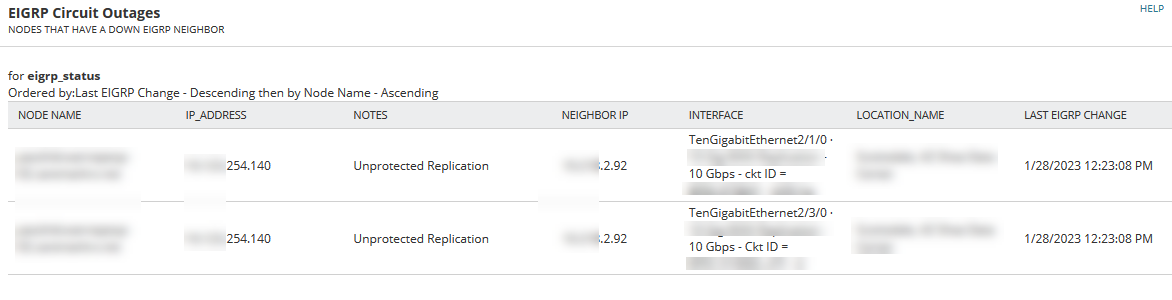

This post has a picture of what looks like having a interface included in their routing table but they did not say how they did it. I've not been able to find a table containing the related interface to the "down" routing neighbor ip.

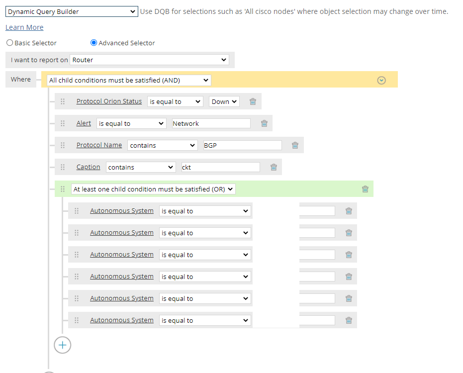

I tried using the builder to make this but it doesn't work, it returns 0 results when we know we have down bgp neighbors. I think because it can't join these tables for some reason or can't find a link between the two?. We are trying to key off the interface caption/alias/description as it has our mpls circuit info in there and we use "ckt" as a key to pull from.

Here is one you can see is showing two interfaces, only one neighbor is down and on this router there are two interfaces with "ckt" in them so how do we show only the relevant one to the neighbor that is down? It is causing our noc to open tickets to the wrong circuit.
