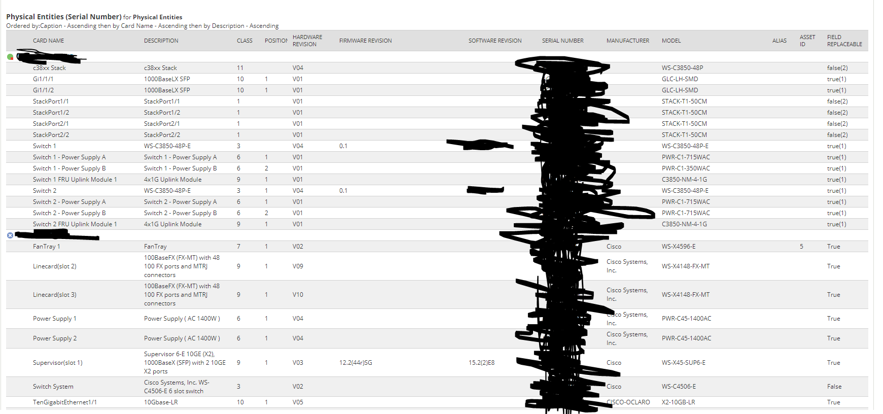

Here is an example of how mine looks.

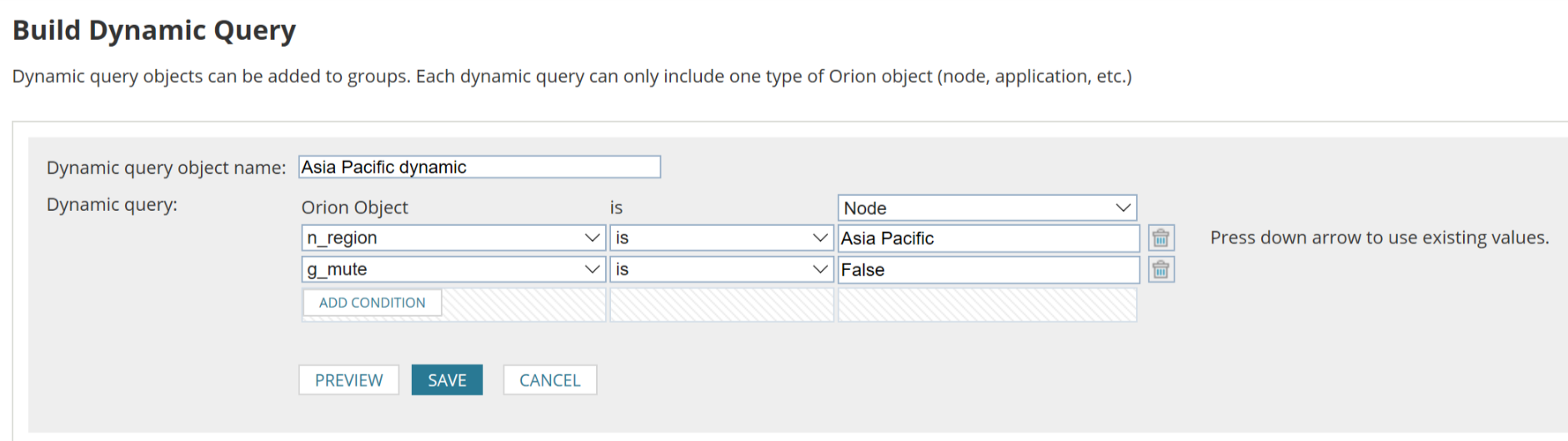

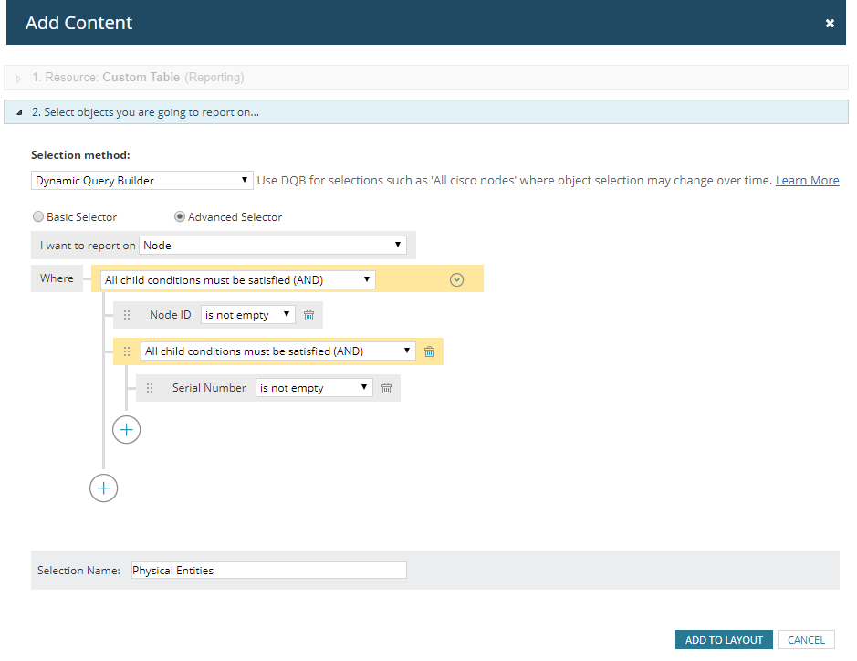

Just copy and duplicate the Cisco 3750 Stack - Physical Entity and edit the dynamic query to match mine
