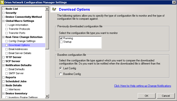

Our system running with NCM 7.0.2. I enable real-time change detection settings in NCM and set download options as Running.

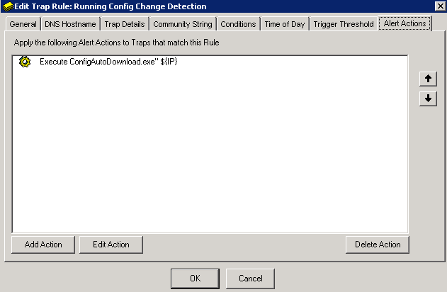

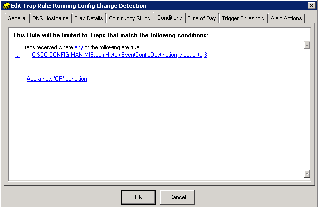

And I use trap viewer to configure a rule to monitor config change traps. Once running change trap received, it will execute ConfigAutoDownload.exe to download running config so we will have a compele config change log for audit.
However, I met issue here that once I set download option as Running(I cannot multiple select both Running and Startup options), ConfigAutoDownload.exe program will only download running configs. My goal is to real-time detect and download config changes on not only running config but also startup config. Thus we will have a accurate running vs. startup conflict report.
Anyone knows the solution please would you share the ideas. I will be highly appreciate. Thanks in advance!
