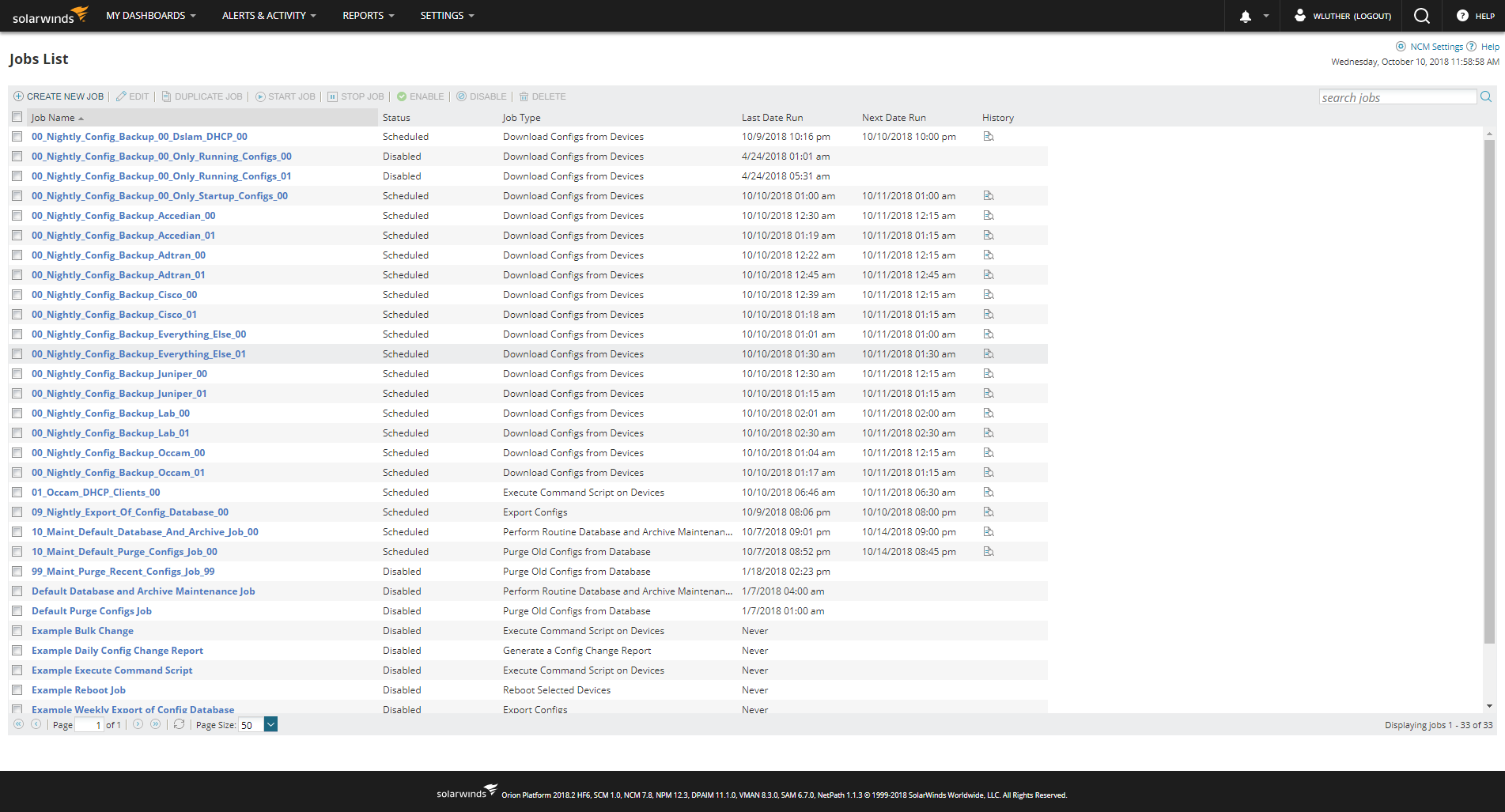

As with most things, we need to start somewhere. That somewhere is the default NCM "Jobs List" page. (/Orion/NCM/Resources/Jobs/JobsList.aspx)
Here is what our example data looks like in its default form. Pretty simple.
While there are many things I would like to see on this page (better/static filtering, independent "Last Date Start", "Current Duration", "Min Duration", "Max Duration", and "Avg Duration" columns, as well as a handful of other basic/standard data to assist with the overall system management), this post is really only going to focus on the basic DAILY view.

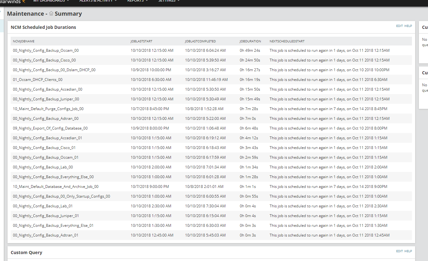

Here is what the results of our SWQL query would look like:
Nothing fancy, but we can clearly see all of the enabled jobs (and none of the jobs which are disabled), when each job started (or so we think... this is where the magic calculations begin), when each job ended, how long each job ran to complete, and a brief summary of when each job will again. Being that the query depends on the difference between the next run date and last end date, manually running the job would alter that time frame, which would produce incorrect data. (A problem to solve at another time?)

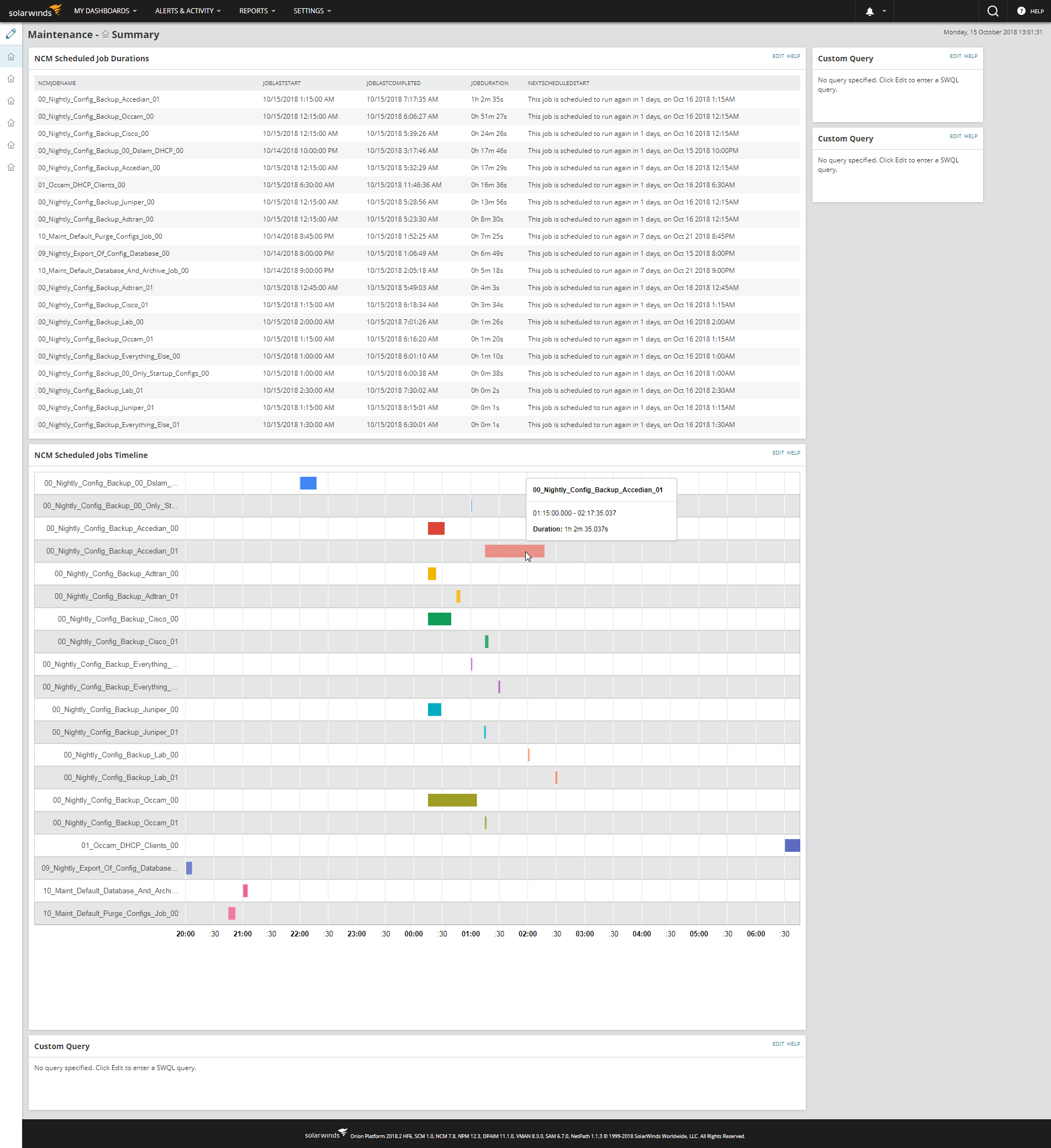

The JavaScript:
Now that we are able to see the data we need, we can dump it into some JavaScript stuff, and hopefully produce a decent looking timeline.

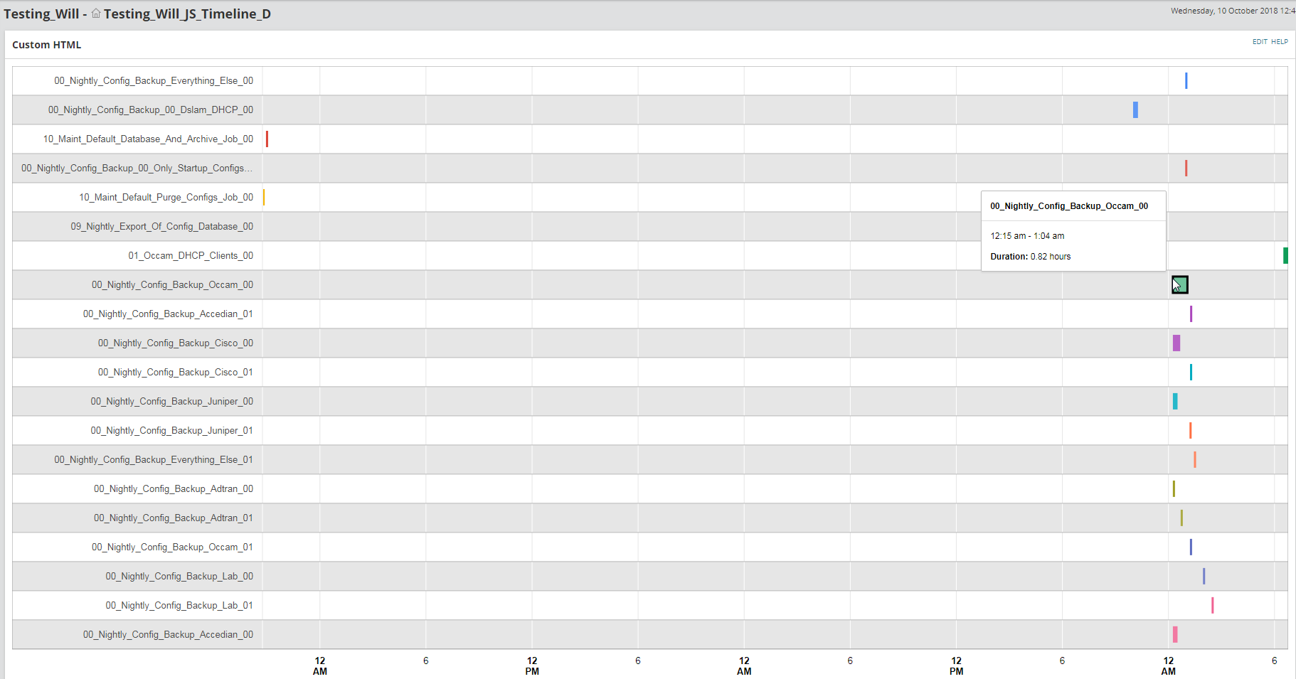

Again, this timeline is NOT perfect... at all... but it should provide a decent way to visualize which jobs are taking long, or which are overlapping with other jobs.
A few things to note:
- The 2 jobs on the far left of the screenshot only run once per week. (Just a heads up as to why they were not invited to join the party with the rest of the data)
- The timeline on the bottom repeats 12AM/6/12PM/6/etc. because, again, the 2 jobs on the far left only run once per week, which happens to be 3 days ago. (When the jobs run closer together, the timeline will automatically become more granular.)
- The timeline does not display full datetimes in the hover over pop-up box.
- The "Duration" value, within the timeline pop-up, comes from the way the chart processes the start and end dates. (The SWQL query inside the JavaScript is a slightly modified version of the query mentioned above. The query above calculates and formats the value for duration differently).

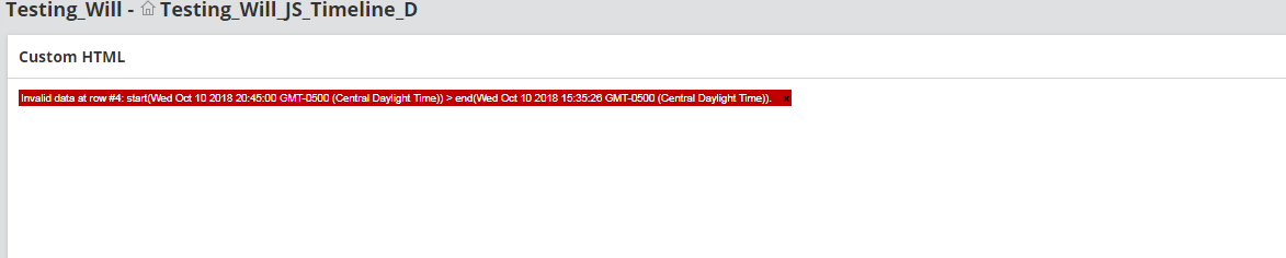

**I have updated the attached file to include a temporary workaround for displaying jobs which were manually started. Manually starting a job will cause the new start time to appear as a date/time in the future, which will break the chart. If/when the new time is set as a future date, later than the end time, this workaround will simply use the last end time as both the start and end time. This will allow the job to be added to the chart at the time it completed running. The next time the job runs at its normal schedule, it should show up with its normal start and end times... Hopefully**
