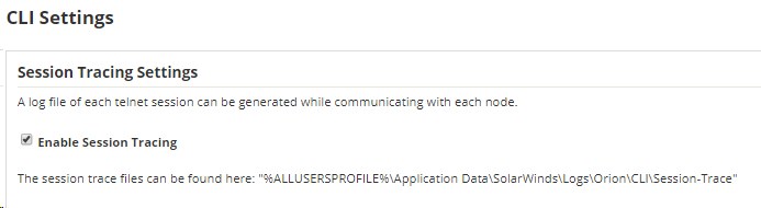

Firstly make sure the Session Trace option is enabled
Settings > All Settings > CLI Settings

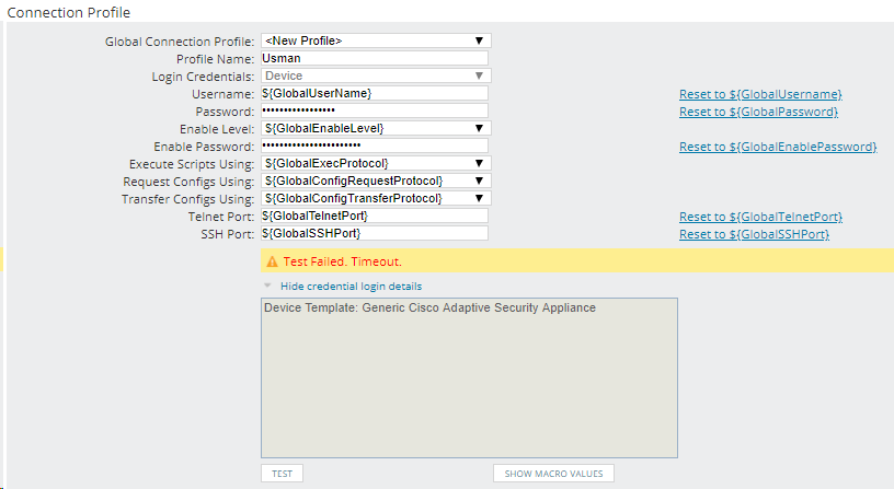

On the Node Details page > Edit Node > (Go to NCM Connection Profile )
Scenario (Time Out with # Login )
In this case It is possible there may be extremely big delays with writing data to session trace.
Such type of issues are usually caused by antivirus software installed on system which continuously monitor write to file operation and delay it.
Please disable session trace logs and that should resolve issue.
Scenario (Time Out with )
In cases there might be device banner causing the issue / Device banner may contained some commands which might be confusing the NCM .
(Please remove the device banner from the device and then try to re produce your test again )
In case issue still exist with disabled traces, first of all turn off Windows Defender Real-time Protection feature (better to turn defender off completely).
Also disable any other antivirus if any installed. Then turn session traces back on and reproduce issue.

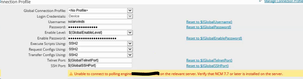

You may can map the OrionWeb.log file if you have such Error in screen shot (Unable to connect to polling engine )
C:\ProgramData\SolarWinds\Logs\Orion
(Please contact solarwinds support if you have such error
System.Exception: Unable to connect to polling engine xxxxxxxxx on the relevant server. Verify that NCM 7.7 or later is installed on the server. ---> System.ServiceModel.FaultException`1[SolarWinds.InformationService.Contract2.InfoServiceFaultContract]: Cirrus.Nodes.ValidateLogin failed, check fault information.)

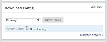

Go to the Node page and (Config Tab) Try download the configuration and keep checking your Session Trace as above
