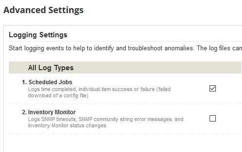

Firstly enable logging Settings > NCM Settings> Advanced Settings > (Enable Scheduled Jobs)
Enable the logging

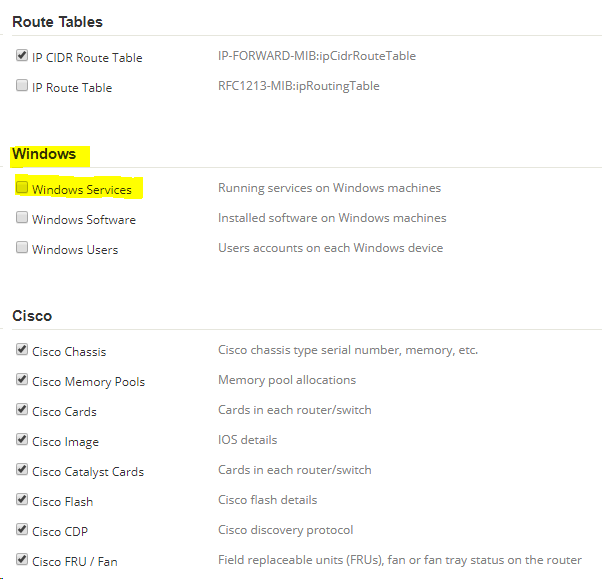

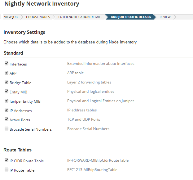

Please Note: Please check your inventory node for the options under inventory settings and select what you really need
Most common cause :
Try not to poll any Rout Tables and uncheck them as nodes can have very large tables and this could result delay completion for the Inventory job.
Please review the Inventory Settings and only select what you really need to poll from the nodes

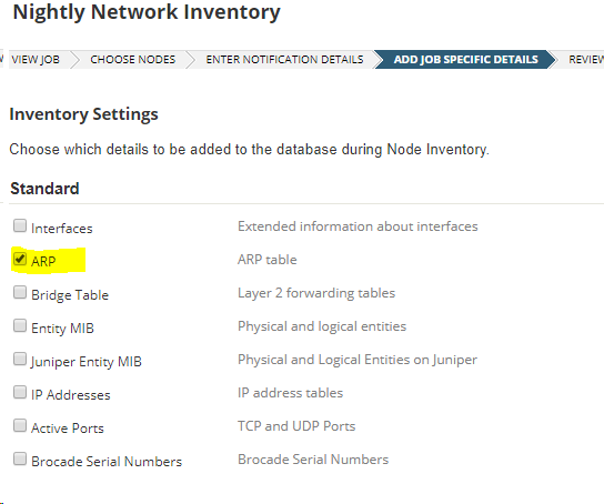

How can i troubleshot and isolate the inventory job issue.
Create a brand new NCM invenoty job > Add only 2 - 5 Cisco Nodes in the job >
Only select ARP option to polll
