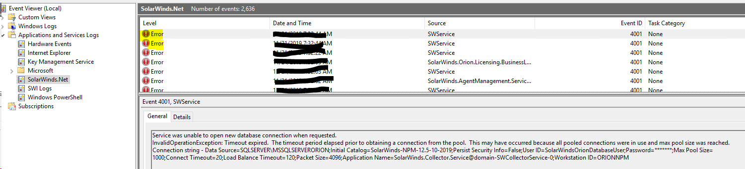

Check Windows Events : SolarWinds.net >> Errors

Cause: NCM Job was running and it got disconnected with SQL Server for some reason
