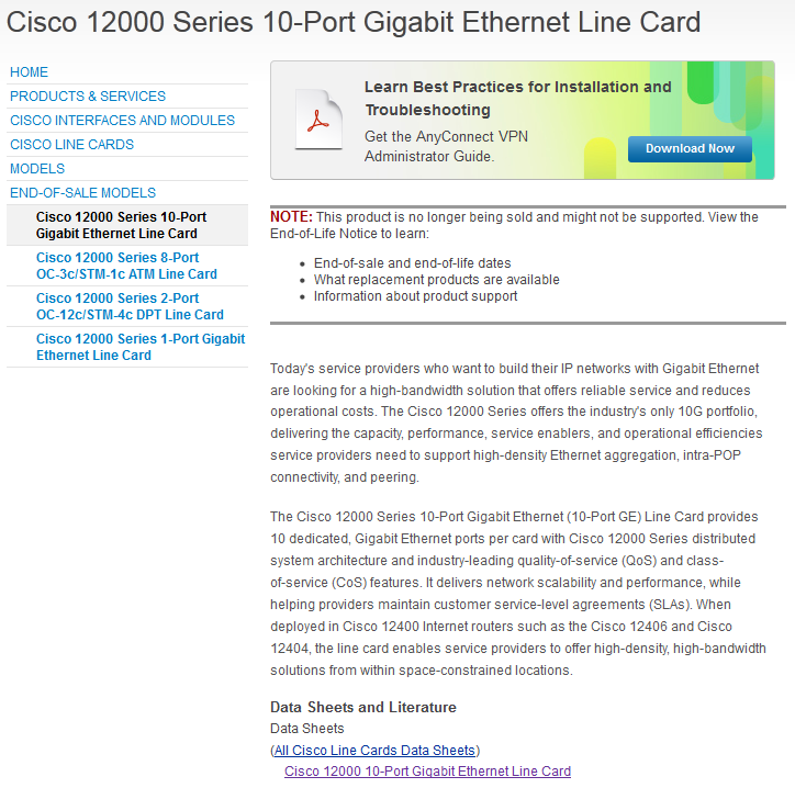

If you do not like the previous option, you can always manage the EoL information yourself. When you try to do that, you will quickly find out that it is not so easy. Let's take Cisco as an example. Their EoL summary page lists lots of products -- routers, switches, firmware, extension modules etc. However for many items, the EoL information is not actually included or the linked page does not contain the required details.
You must also realize that a device often consists of several parts some of which reach end of life sooner than the rest (e.g., certain firmware version). Last but not least, different vendors publish EoL statements in different formats or even require a partner account for access. Google may sometimes help but not in 100 % cases.

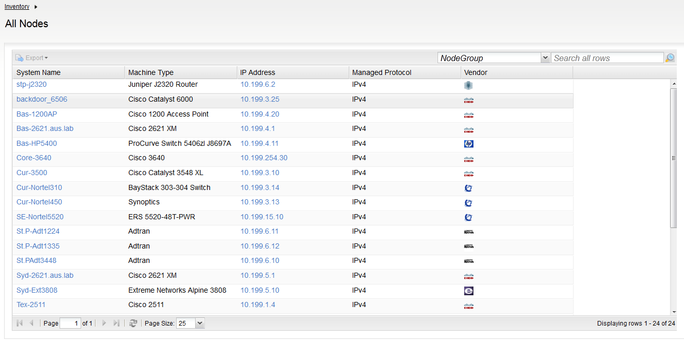

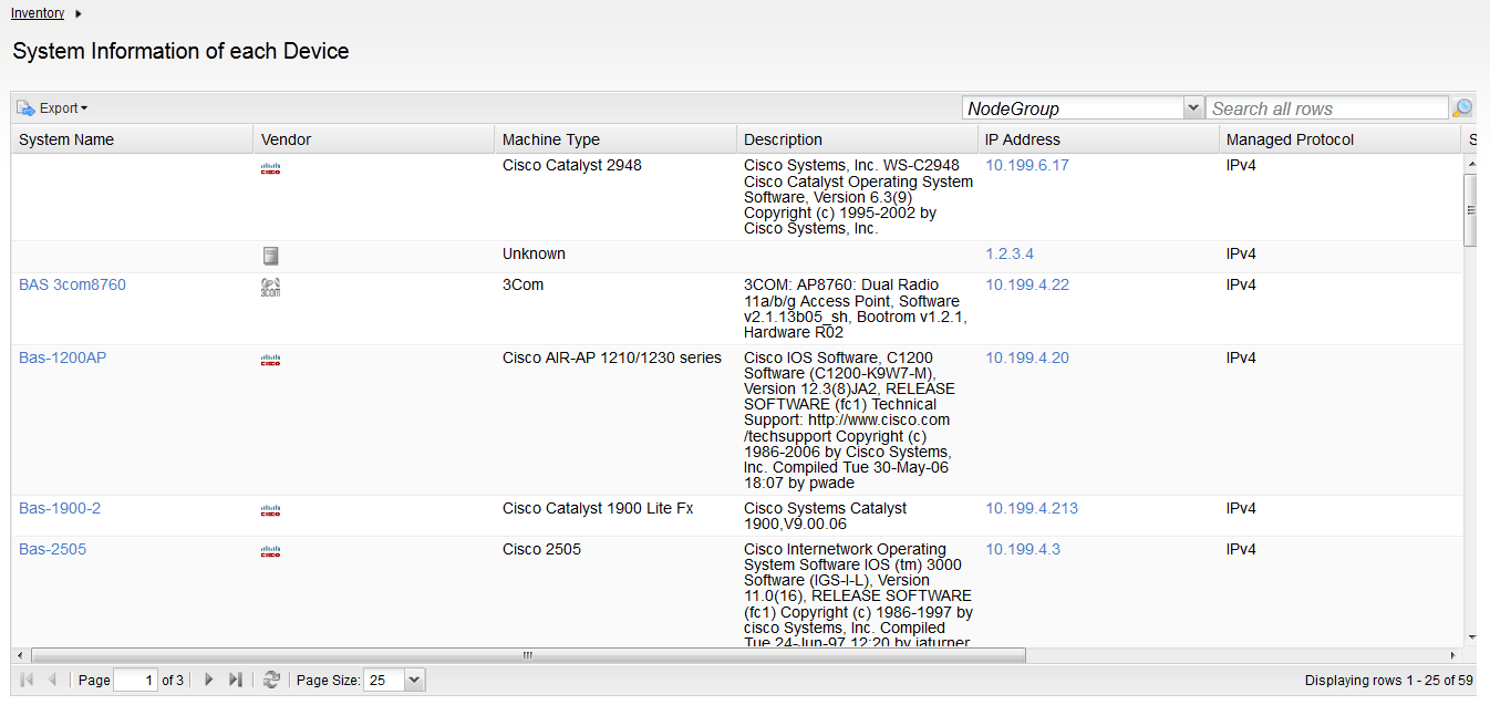

The EOL Lookup space does not have the ambition to replace the 100% accurate service that you can purchase from the vendors or professional services providers. It is intended as a tool for the do-it-yourself approach. How do you use it with NCM? First, you must select an inventory report that enumerates all your devices. Good candidates are 'All Nodes' and 'System Information of Each Device'. (By default, these can be found in the 'Node Details' category.)

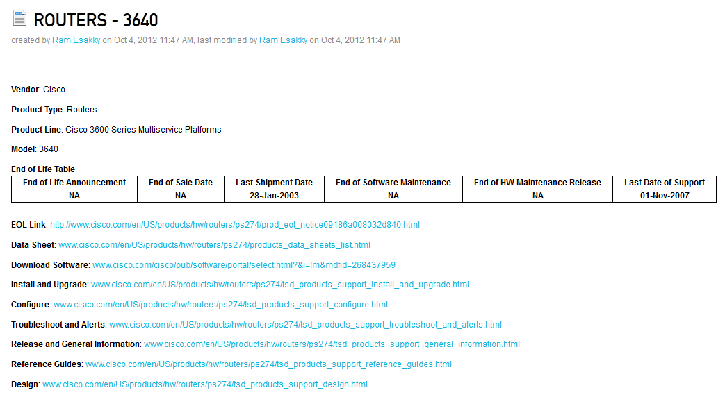

Let's assume you want to find out the EoL status of the 'Core-3640' router. In the EOL Lookup tool, you enter the appropriate information:
and get the result:

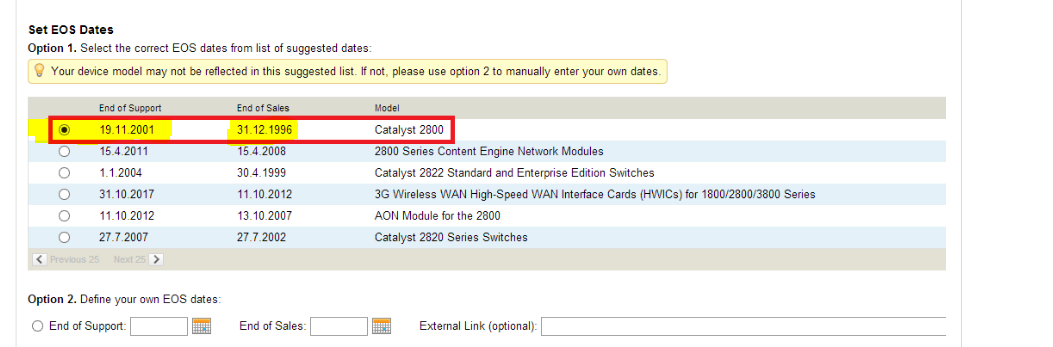

You have various options how to record the EoL information for your devices, e.g.:
- Export the NCM inventory report in Excel format and add the information there. As you will probably have multiple devices of the same kind, you can group the result according to Machine Type and attach EoL data in bulk.
- Create a custom property and fill in the EoL information. Again you can select all nodes of the same type and define the EoL info at once.
