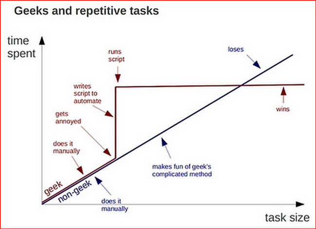

However, planning the pseudocode alone became a rabbit hole in which we chased modules on GitHub, snippets from previous scripts, and random links in Google trying to figure out the best way to accommodate all the funny nuances of this customer’s network. In the long run, if this was a very common task, we would have benefited greatly from putting in all the time and effort needed to nail our script down simply because it would then be re-usable and shareable with the rest of the community. However, by the time I checked in again with some more ideas, my friend was already well underway configuring the switches manually simply because it was billable time and he needed to get the job done right away. There’s a balance between diminishing returns and long-term benefits to writing code for certain tasks.

Network automation seeks to decrease human error, but the process requires skill, careful peer review, and maybe even a small test pool. Otherwise, the blast radius of a failure could be very large and impactful. There is also great automation software out there with easy-to-use interfaces that can enable you to save time without struggling to learn a new programming language.
