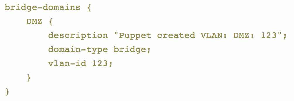

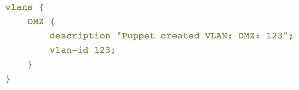

Picking on Junos OS as an example, the standard Puppet library supports the configuration of physical interfaces, VLANs, LAGs, and layer 2 switching, and, well, that's it. Of course, there's something deeper here worth considering: the same manifest configuration works on an EX and an MX, despite the fact that the implemented configurations will look different, and that's quite a benefit. For example, consider this snippet of a manifest:
On a Juniper EX switch, this would result in configuration similar to this;
On a Juniper MX router, the configuration created by the manifest is quite different:
The trade-off for learning the syntax for the Puppet manifest is that the one syntax can be applied to any platform supporting VLANs, without needing to worry about whether the device uses VLANs or bridge-domains. Now if this could be supported on every Juniper device and OS version and the general manifest configuration could be made to apply to multiple vendors as well, that would be very helpful.
