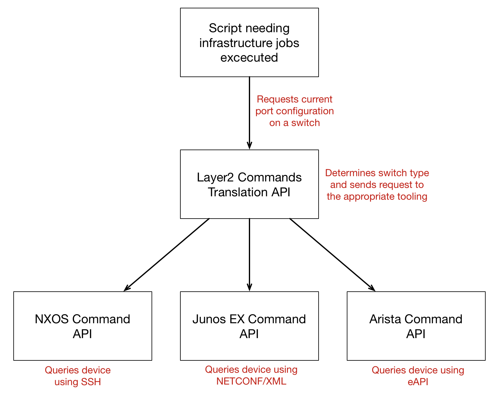

One of solutions I proposed to the silo problem is for each team to provide documented APIs to their tools so that other teams can include those elements within their own workflows. Most likely, within a technical area, things may work best if a similar approach is used:

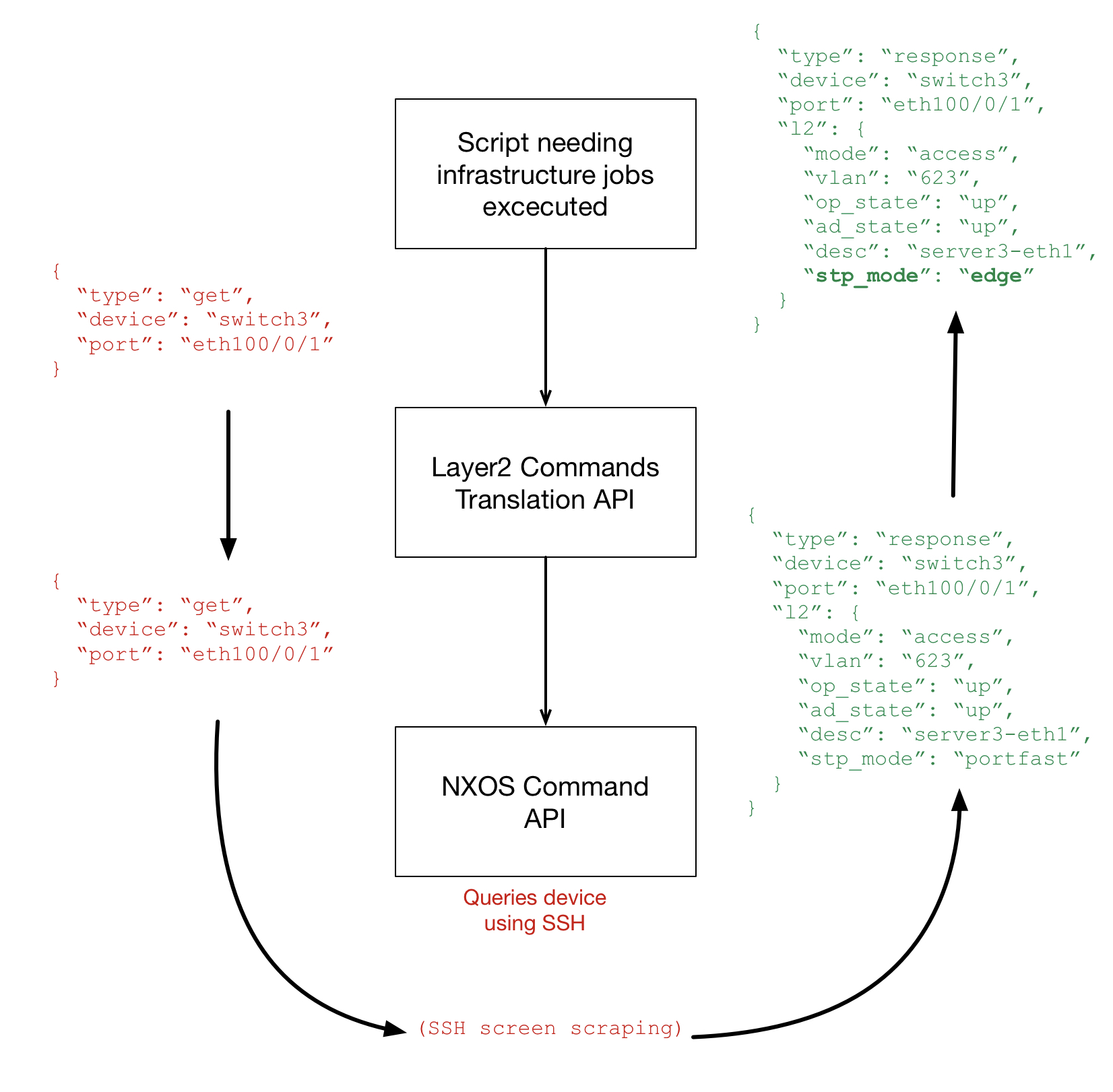

Arguably the Translation API could itself contain the device-specific code, but there’s no getting around the fact that each vendor’s equipment will require a different syntax, protocol, and transport. As such, that complexity should not be in the orchestration tools themselves but should be hidden behind a layer of abstraction (in this case, the translation API). In this example, the translation API changes the Cisco spanning-tree “portfast” into a more generic “edge” type:
