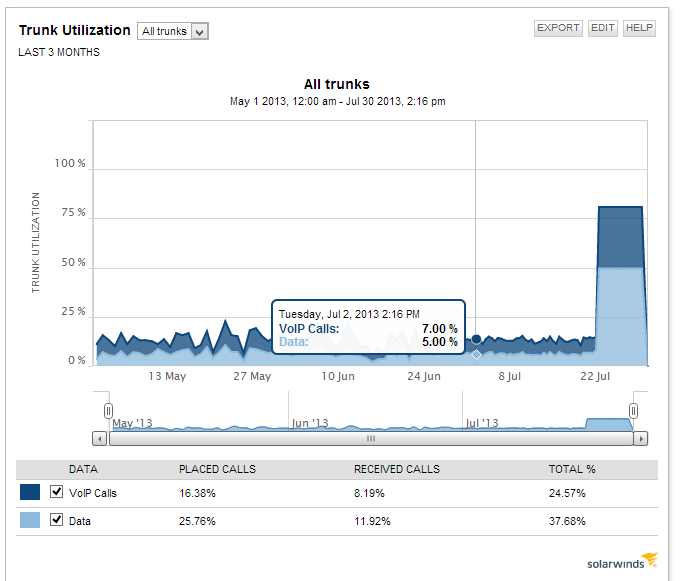

How to see data distribution and PRI trunk utilization - are you paying too much to your provider?
Data distribution chart can show you a total usage on your PRI gateway, data & VoIP traffic
distribution and you can also drill down to see each trunk utilization specifically. "Trunk Utilization" resource will give you a good historical overview where you may see spikes or gaps over a time.
In our case, we can see that more than 37% of the capacity
is not used over last three months. So why to pay so much to your voip/data provider?
You can reduce amount of lines you need for the connectivity with the outside world.
The same chart could be also used for a troubleshooting of call connectivity.
In a case you reach maximum PRI utilization, your calls can't be connected
and it's time to figure out who is causing such load (CDRs), ask your provider for more bandwidth, or, at least, set up VoIP precedence policies.
Want to see more "per trunk" utilization details? Not a problem:

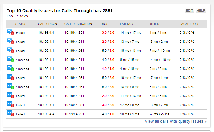

How to see problems on a gateway?
It's possible to do it via VNQM search page itself. But, you can save some time and see the most important metric - failed calls, and call quality issues directly on each Gateway detail page:
In order to see call details, phone numbers, etc. simply hit "Search for all failed calls" link at the bottom of the page and VNQM will filter out Gateway relevant calls only."Easy peasy" don't you think?
