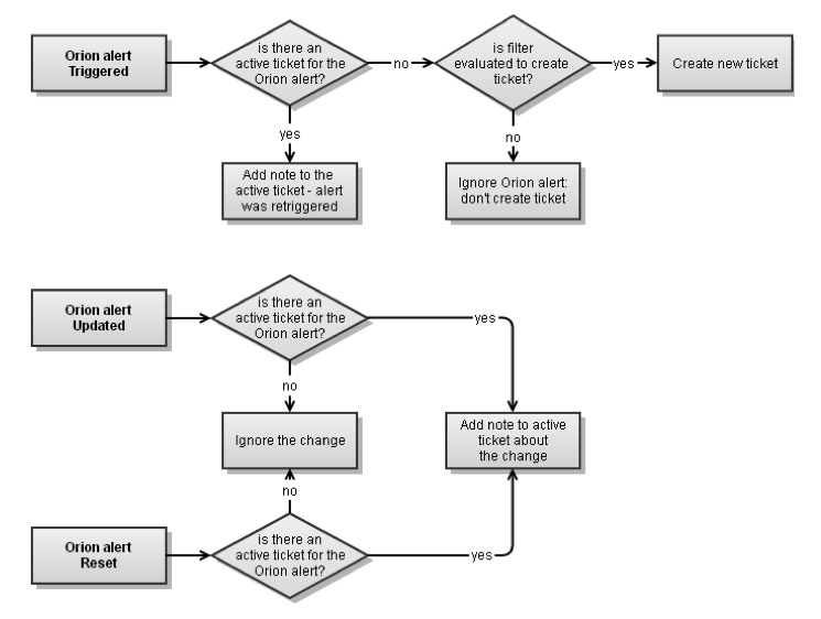

Whenever a change occurs in SolarWinds Orion, the change triggers, updates, or resends an Orion alert. After you have established a SolarWinds Orion-to-WHD connection, Orion sends an HTTP request with the change to WHD. An example of this type of change could be a WHD ticket (based on an advanced alert) updating when someone adds a note or acknowledgement or changes the status from the Orion interface.
Here’s what the Orion-to-WHD communication process looks like:

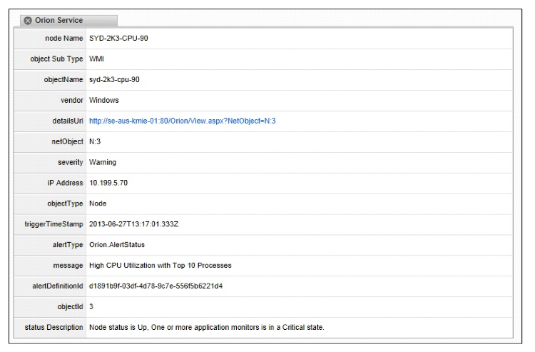

And here’s a sample of what you can get:
