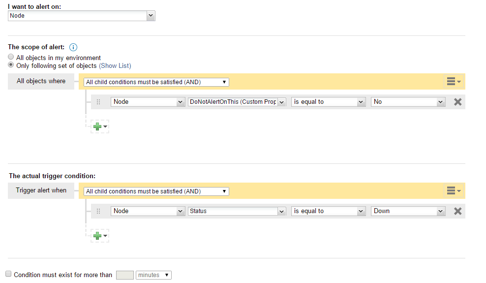

Let’s start really simple, and assume you’ve got a handful of devices that you need to monitor, but that you don’t need alerts for them. Create a Boolean (Yes/No) custom property called DoNotAlertOnThis. By default, custom property Boolean values default to false – so all you need to do is set this to True for these ‘noisy’ devices.
Set up your alert like this:

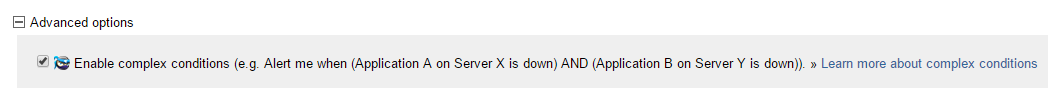

With the complex conditions options in 11.5 the possibilities are endless, so rather than talk about specific case studies, let’s talk about some of the awesome logic options you can now apply to your alerts.
First, enable the “Complex Conditions” on the “Trigger Conditions” tab of your new alert:

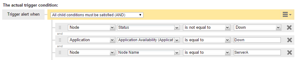

And finally, as my last but definitely not least tip of the day – let’s take a look and stringing conditions together. There’ll be times when you might only want to get an alert when two (or more) very distinct conditions occur at once, and when you’re fighting fires, it can be hard to correlate a bunch of emails together to see if that scenario actually happened or not.
The classic example of this would be to check the status of two separate applications on two separate servers – maybe you can hobble along with just one, but you might need a critical alert sent out if you lose both.
Using the standard alert conditions, you can create an alert to alert on just one of those applications. If you were to add ‘Node name is equal to ServerB’ in here, it could never trigger – as no server can be named both ‘ServerA’ and ‘ServerB’ at the same time.

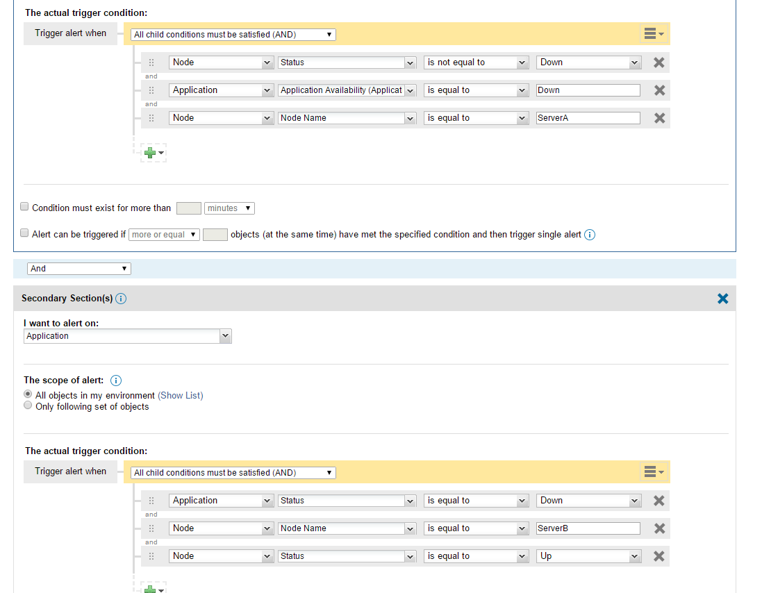

This is where the complex condition is king. You can now alert as:
So now an application would have to fail on both Server A and also fail on Server B in order to generate this alert.
Here’s where it gets super interesting – the conditions don’t have to match. In fact, they don’t have to have anything to do with each other at all, other than both resolving to ‘true’ conditions in order for the alert to fire. And you can add as many of these additional conditions as you like to get truly granular and complex alerts.
