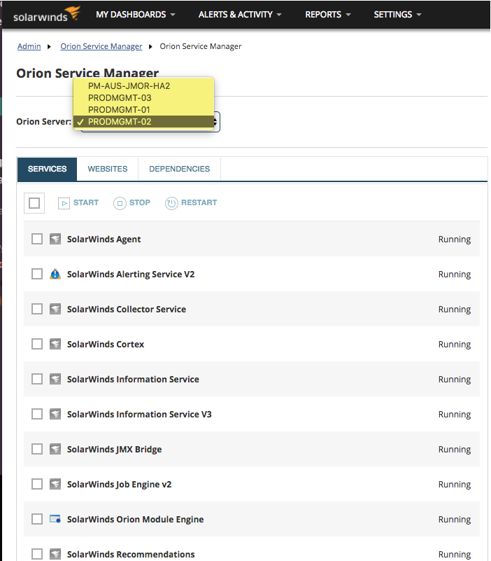

This was implemented in Orion Core 2016.1 as the Orion Service Manager. It can be found in the Orion web interface under [Settings -> All Settings -> Orion Service Manager]
