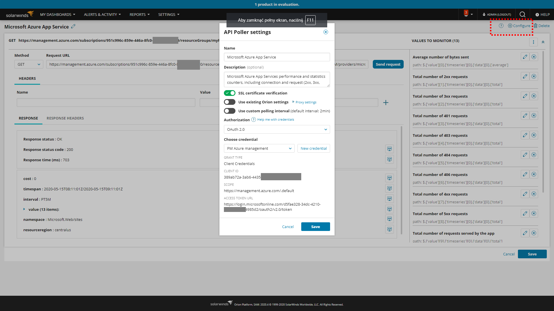

Thanks for the response and help! I actually just installed 2020.2 earlier today. It's pretty cool and looks like it may get me past my struggles. Just need to mess around with it a little more. I should have an update over the next few days.
LatteLarry interested in your outcome. We are still on 2019.4 and a device requires token authorisation
