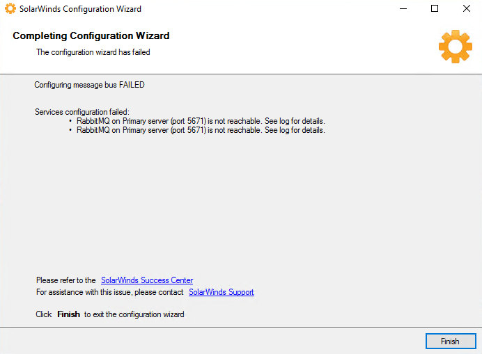

Hi, has anyone had the following after upgrading to 2022.4 on APE & AWS?
MPE is OK but get the same CW error on 5 x APE and AWS.
Have tested port connectivity on from APE to MPE looks OK
Thanks
Thanks @bshopp this was resolved by Tech Support doing a full repair on the MPE, then running config wizard on all the APE/AWS

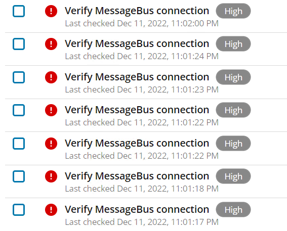

Yes, same situation as us and we rolled that environment back to 2022.3The other (large) environment that we have on 2022.4 has 2 of our APEs with the above message, but the rest are fine. Like you say - we started the services and they seemed to be working.
Strange one, we even had the team remove McAfee and turn off firewall without success.
Logging into RabbitMQ Console shows no connections.
Not sure if reinstalling RabbitMQ might resolve, will wait for official comms.
