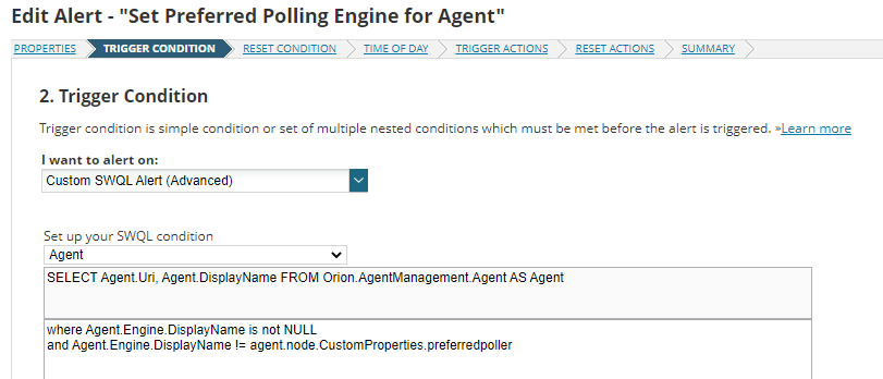

High-Level Design:
The workaround is to use a custom property assigned to each node, to track the preferred poller. When the agents come online they will automatically reconnect to the main poller (based on the MFT configuration). But we can use an alert then that compares the custom property value with each agents assigned engine. Then the alert trigger can call a powershell script, using the "Assigntoengine" verb.

To download an example of how to configure the alert, see this post. https://thwack.solarwinds.com/content-exchange/the-orion-platform/m/alerts/3733
The logic for the alert trigger is some SWQL, and the reset is just when the trigger condition is no longer true.
For the trigger action, you can call the script above, and pass in the following arguments
PowerShell -NoProfile -ExecutionPolicy Bypass -Command "& 'E:\Scripts\Agent_Reset.ps1' -nodeid {N=SwisEntity;M=Node.NodeID} -enginename ${N=SwisEntity;M=Node.CustomProperties.PreferredPoller}"
