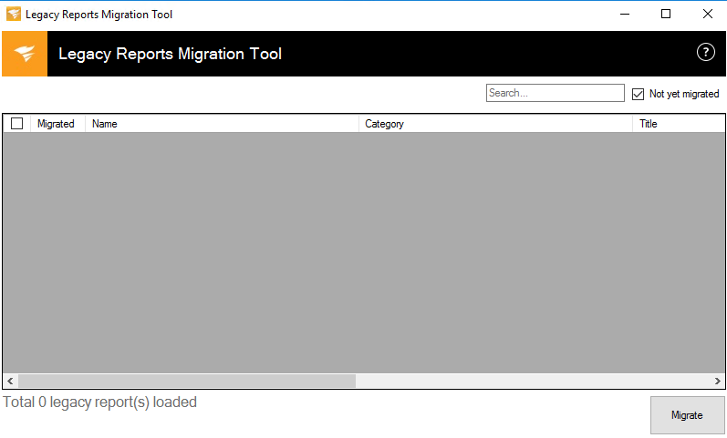

Hi, everyone! I'm working on migrating all legacy reports prior to upgrading Orion beyond 2020.2.6, when they will stop working. Has observed this issue after following the process that is documented in https://www.solarwinds.com/documentation/helploader.aspx?topic=orioncorereportmigrationtool?
I ran the Legacy Reports Migration Tool quickly and with no problems. After running it, I checked the "not yet migrated" box, and the list was empty.
The log file (C:\ProgramData\SolarWinds\Logs\Orion\Solarwinds.ReportMigrationTool.log) indicates that all reports were migrated successfully.
However, when I log into the web console and go to the Manage Reports page, there doesn't appear to be any change. All 104 reports are still listed as "ReportWriter (Deprecated)" with the Default limitation applied. The deployment health check also still detects legacy reports.
The document says that the migrated reports will show in the "No Reports" category and be limited to only administrators, but that category is empty /does not exist.
Is there a delay on this process, or any way to force a refresh of the reports' configuration?
