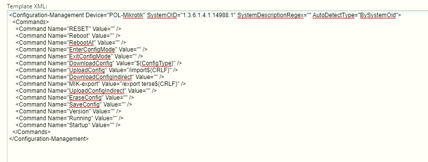

The device template which i use is as below:

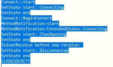

The Logs which exist for the connection problem:
