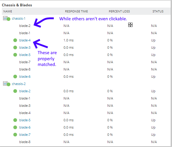

- In our environment at least, it seems that for most of the blades, if Orion doesn't match it to an existing Orion Node then the blade isn't clickable at all. We do have a few blades that aren't matched to nodes that we can click on and it gives us the option to manage, but a vast majority of our blades are not clickable at all, even though in reality most of our blades are populated by ESX hosts in the real world. I just can't figure out how Orion decides whether a blade is clickable. I've seen some suggestions that the fiber interconnect needs to have an external IP set, but that doesn't seem to matter as blades that are attached to FI's with the external IP set seem to have the same amount of trouble being matched to Orion nodes as ones without. I also maybe thought it had something to do with blades having their IP set a certain way, but that doesn't seem to matter either. Some of the blades have IP's recorded in the SolarWinds database and plenty don't, and the ones that do have IP's recorded in the DB aren't matched at a better rate than the ones without

And here's a quick sample of how pretty much all of our UCS manager pages look:
